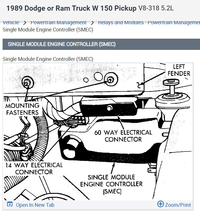

Why can't I find it thought it would be on firewall

It is located to the right side of the battery inside the fender. IF you have a 5.2L (318) motor

The Single Module Engine Controller (SMEC) is located in the engine compartment on the left inner fender. Here is the location in the images below.
Image (Click to make bigger)
