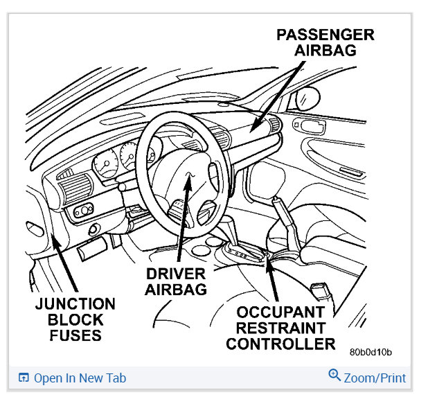

This happens when the horn pad (airbag )needs to be replaced here are the instructions in the diagrams below.
REMOVAL
1. Open hood and disconnect the negative battery cable remote terminal from the remote battery post .Wait two minutes for the system reserve capacitor to discharge before servicing any airbag components.
2. Remove speed control switch screws from steering wheel back cover, remove switches and disconnect the wires.
3. Remove two bolts retaining Driver Airbag.
4. Lift airbag and disconnect the two airbag initiators, and horn switch wire connectors.
5. Remove Driver Airbag from vehicle.
WARNING: WHEN REPLACING A DEPLOYED DRIVER AIRBAG, THE CLOCK SPRING MUST ALSO BE REPLACED. REFER TO ELECTRICAL, RESTRAINTS, CLOCK SPRING, REMOVAL, AND INSTALLATION. FAILURE TO DO SO COULD RESULT IN OCCUPANT PERSONAL INJURY OR DEATH.

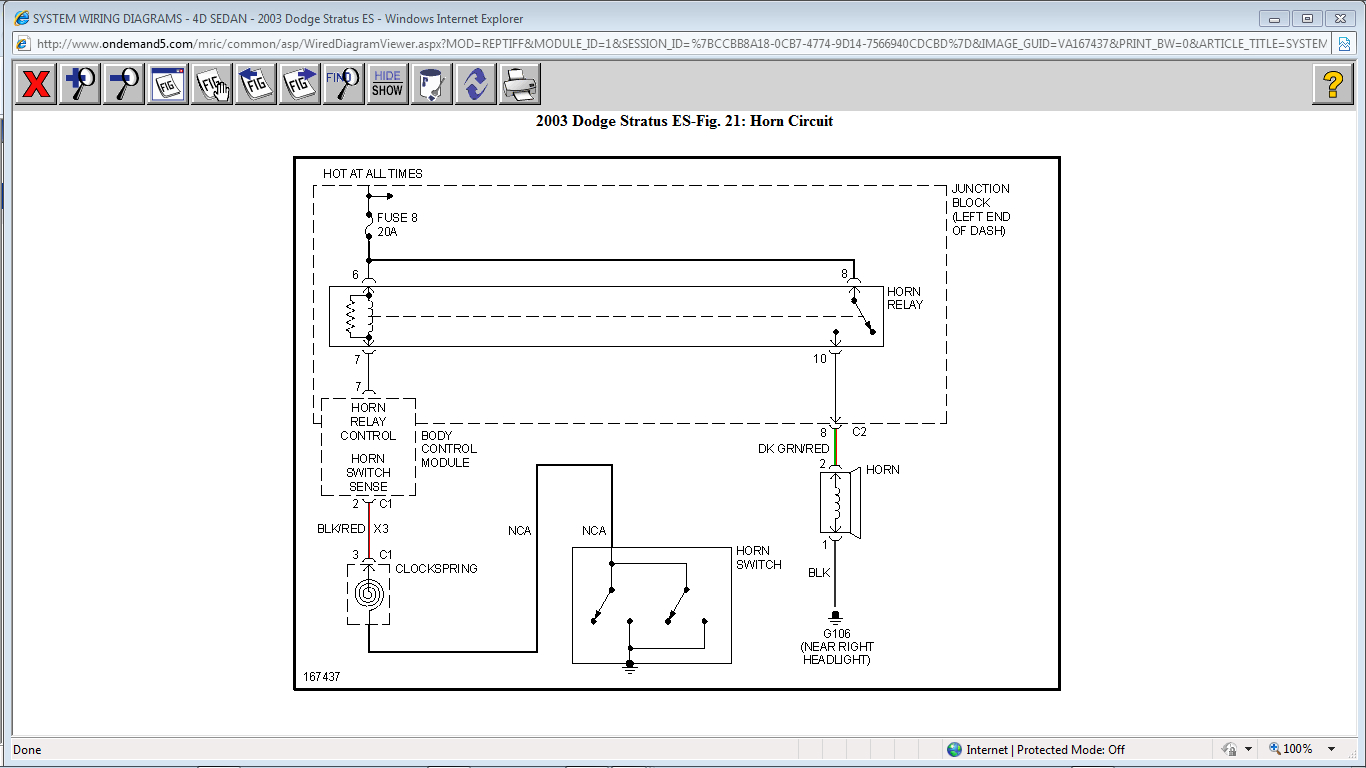

There is a short somewhere in the steering column or the horn relay. The horn relay is on the junction block, which is located at the left end of the dash.

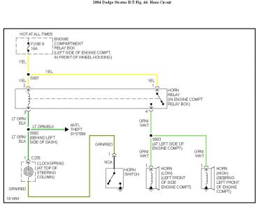

I have a 2004 Stratus R/T Coupe which as you know is basically the same as an 3g eclipse gt. The other day I blew my horn when i realized it doesn't sound right. Only my high note horn is working. I went and bought a new low note horn and installed it. Upon testing it, I realized it is still not working.
So I checked fuses and relays, all are fine. However, the low note horn still isn't working. I tried testing the horn out in a different car and it works fine.
I'm thinking something is wrong with the wiring or something. Could you possibly provide with me a wiring diagram of where the wiring is for the horn? I'm not sure what's wrong with it.

Hi grn4frk, Thank you for the donation. The high and low horns are connected in parallel circuit and since the high is working, the low should be as well.
https://images.2carpros.com/forum/automotive_pictures/192750_HornCircuit04StratusFig44_1.jpg
Check the continuity between the Green/White wires and if no continuity is found, the wire is broken in between.

Is there any way you can get a bigger picture?
and are you sure that's the wiring diagram for the stratus coupe. the sedan & coupe are totally different and usually it would say coupe at the top of the picture, just wanted to make sure that was right.
Thanks.

The circuit is for coupe. I have emailed the diagram to you as it is not possible to increase the size here.
You are correct about the coupe and sedan having different circuits.
