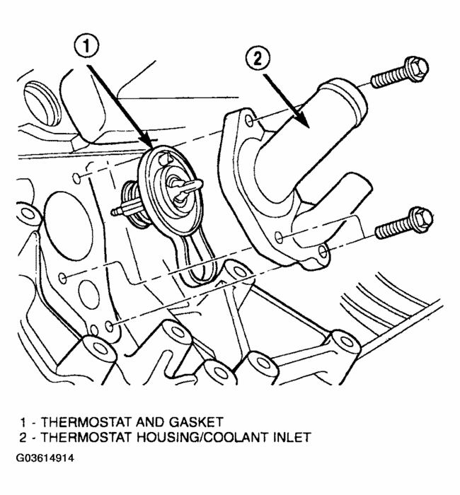

The thermostat is located on the lower left near the front. It is on the inlet side of the waterpump. I have attached a picture for you. As far as bleeding the system after the job is done, it has an air bleed on the flange of the thermostat to allow trapped air to exit when refilling.

Yes, from the front. You will see a large radiator hose going to it and a smaller hose (for the heater core).
I'm glad you emailed back. I reviewed our posts. I wanted to mention to you to make sure the bleeder on the t-stat flange needs to be in the 12 o'clock position.

Ok, it wont show pictures but it is at the end of the upper hose to the cylinder head. Easy job.
REMOVAL
WARNING: DO NOT REMOVE PRESSURE CAP WITH THE SYSTEM HOT AND UNDER PRESSURE BECAUSE SERIOUS BURNS FROM COOLANT CAN OCCUR.
Drain cooling system to the thermostat level or below.
Disconnect hoses at coolant outlet connector.
Zoom Sized for Print
Remove bolts attaching coolant outlet connector.
Remove coolant outlet connector and thermostat.
INSTALLATION
Clean sealing surfaces.
Place the new thermostat assembly into the coolant outlet connector. Align air bleed with notch on the coolant outlet connector.
Install coolant outlet connector onto thermostat housing and tighten bolts to 12.5 Nm (110 inch lbs.).
Connect hoses to coolant outlet connector.
Fill cooling system.

Locate your upper radiator hose. Follow that hose towards the engine block. You will see the thermostat housing with two bolts securing it.
