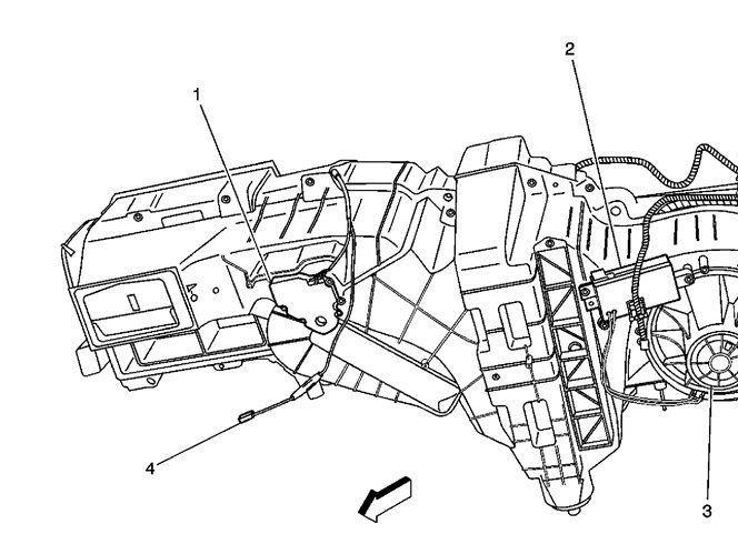

check for proper tstat install. then check the actuators in your heater i'll send a generic pic along

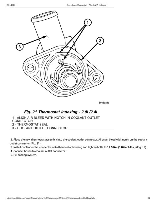

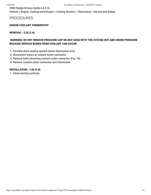

JOETECHPRO
  • 705 POSTS
Hey GAIL CRISP DALTON,
Please see the instructions below on thermostat replacement for your vehicle.
You should be able to see orientation from the picture in the instructions.
Any further questions do not hesitate to ask.
Regards, Joe
Oct 27, 2020 at 10:03 AM (Merged)

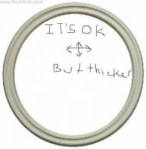

TWINKEY1
  • 49 POSTS
Engine Cooling problem 2003 Dodge Stratus 4 cyl i had a little leak on my thrmostat housing,so went to a parts store to get a new Thermostat Housing Gasket,since i was there picked up a new thermostat and it doesnt call for a regular gasket,just the seal,so when i went to put it in it did fit around the thermostat and inside the housing but when i went to put it on the block to tighten it down it seem way to big,seal didnt fit flush in the housing like the old one did,so i decided to go to a dodge dealer to get one but theres the same way,i was told it was an updated seal and it will fit,tighten it and it will compress to make a seal,so was wondering where they updated and should i use it
https://images.2carpros.com/forum/automotive_pictures/221946_getimage_1.jpg
Oct 27, 2020 at 10:04 AM (Merged)
XSHAWN117X
  • 12 POSTS
You shouldn't have a problem. I have that exact seal and had replaced mine a few months ago and haven't had any leaks.

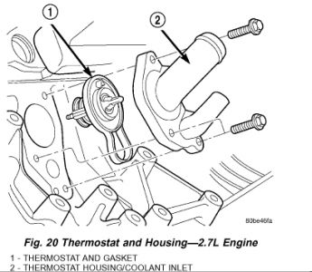

SCHMIEDY11
where is the thermostat in this stratus
  • 75,992 POSTS
Fig. 20 Thermostat and Housing - 2.7L
https://images.2carpros.com/forum/automotive_pictures/12900_t_8.jpg
https://www.2carpros.com/kpages/auto_repair_manuals_alldata.htm

SHANJANA
where is thermostat located and how do I replace it
ok, it wont show pictures but it is at the end of the upper hose to the cylinder head. easy job.
REMOVAL
WARNING: DO NOT REMOVE PRESSURE CAP WITH THE SYSTEM HOT AND UNDER PRESSURE BECAUSE SERIOUS BURNS FROM COOLANT CAN OCCUR.
Drain cooling system to the thermostat level or below.
Disconnect hoses at coolant outlet connector.
Zoom Sized for Print
Remove bolts attaching coolant outlet connector.
Remove coolant outlet connector and thermostat.
INSTALLATION
Clean sealing surfaces.
Place the new thermostat assembly into the coolant outlet connector. Align air bleed with notch on the coolant outlet connector.
Install coolant outlet connector onto thermostat housing and tighten bolts to 12.5 Nm (110 inch lbs.) .
Connect hoses to coolant outlet connector.
Fill cooling system.

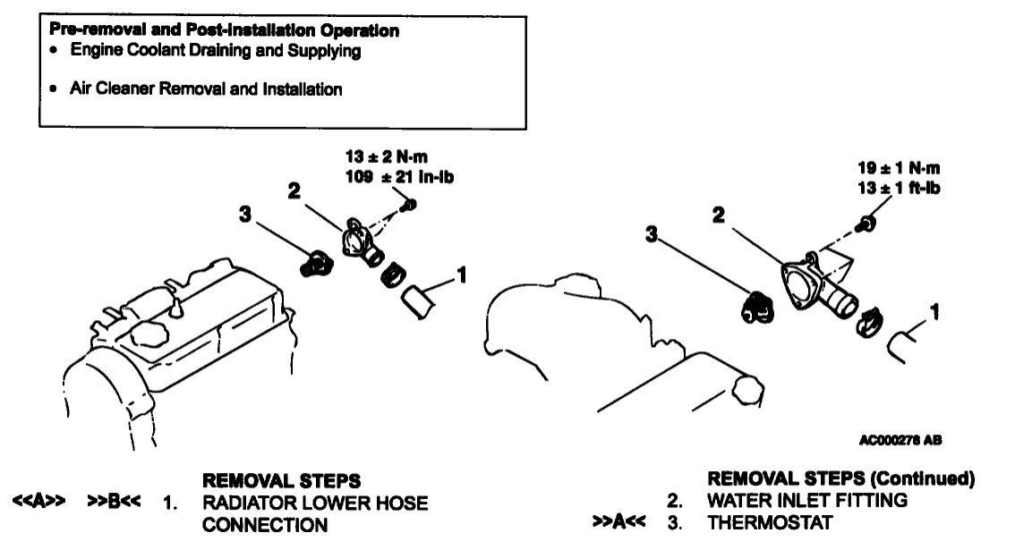

DAVE MC DONALD
Where is the thermostat located on a Dodge Stratus with a 2.4 engine.
Also the door a-jar keeps going off when the door is shut. Is this a sensor and if so where is it located so i can replace it.
Oct 27, 2020 at 10:05 AM (Merged)
ZACKMAN
  • 4,202 POSTS
Locate your upper radiator hose. Follow that hose towards the engine block. You will see the thermostat housing with two bolts securing it.
One of your door switches is bad. Figure out which one and replace. It is located on the door sill.
