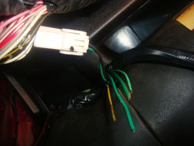

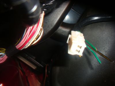

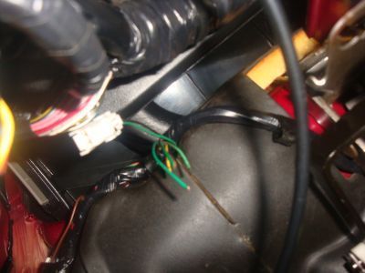

when I bought my car used someone had cut out the brake light switch wires. I went and got the a used switch from a junk yard that has 6 wires but I only see 4 wires that were cut. how do I wire the switch.

checked it again and i see 4 wires that were cut I will try to get a picture of them tonight. one is green with orange stripe no breaking off in sections on this, one is yellow one is light green and the other is green with no stripe. I bought this car used and it came as is. I just want my brake lights to work, I really don't use cruise control. the light always stays on this so i removed the fuse

here iare 3 pics the last one doesn't go anywhere i don't know what goes in this clip type thing
https://images.2carpros.com/forum/automotive_pictures/579570_DSC01640_1.jpg
https://images.2carpros.com/forum/automotive_pictures/579570_DSC01646_1.jpg
https://images.2carpros.com/forum/automotive_pictures/579570_DSC01647_1.jpg

green and black is power. it goes to pin 2 of the switch the orange and green goes to pin one of switch and runs to the computer. from there the brakes are controlled by a solid state relay inside of the ECU
