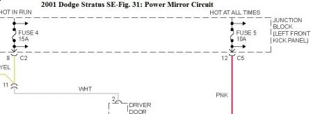

my daughter called afew days ago and told me smoke was coming from driver side door while she was driving. Unsure what the cause was, I told her to pull the fuse (10a) for the heated mirror shown on the f block panel. Mirror button appears melted (it was hot) now and non functional. It seem to subside until she got home, didn't drive much over the weekend, then today it started smoking again, now radio doesn't work. Appreciate your help.

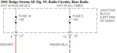

If you look at both circuit, you'll see that they both share fuse #5. Surely, when you pulled the fuse for the power mirror circuit, radio quits working.

As the smoke came out of the driver door, I am under the assumption that the wiring to the power mirror may have touched the metal part of the door, causing it to short circuit and spark, causing the plastic and possibly fabric to catch on fire.
