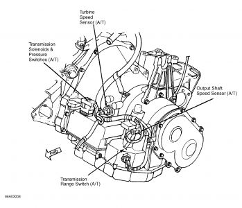

My son's 2000 Stratus' check engine light came on and the speedometer stopped working. When he is in drive and takes his foot off the accelerator it feels like it is braking. I'm told it is stuck in 2nd gear. A friend told me this could be caused by a broken sensor. True? How easy to replace?

Check engine light on? if yes have codes read will tell what is faulty . most likely failed output speed sensor
https://images.2carpros.com/forum/automotive_pictures/198357_Graphic_611.jpg
