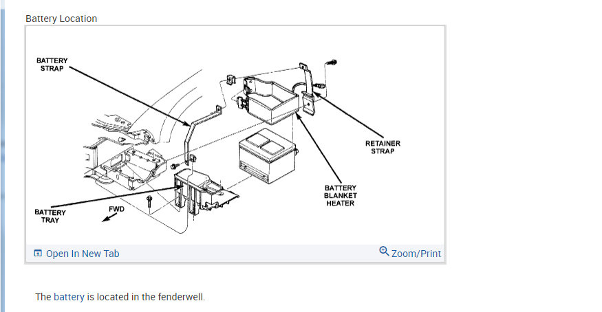

Where is the battery located?
Wednesday, May 7th, 2008 AT 12:38 PM

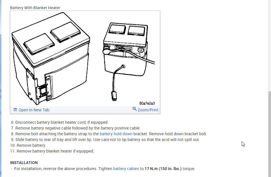

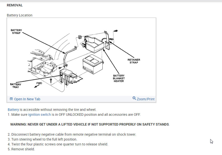

The battery is located in the driver side fender well of the vehicle. I attached the procedure on how to replace it. Please see the attached documents for this.
Also, here is a guide that will help in more general terms on how to replace a battery. It will help once you find the battery in your vehicle.
