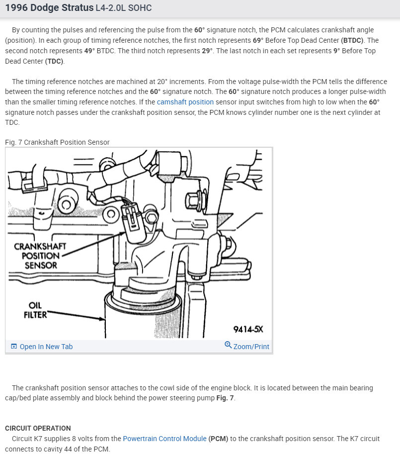

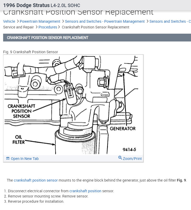

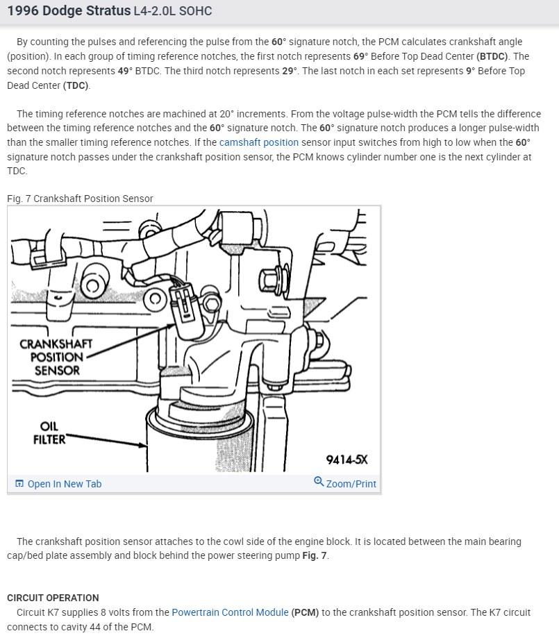

Hello pedalmonkey120343
Yes, there is a specific way to install it, but is not complicated.
The crankshaft position sensor should be adjustable, which is identifiable by the presence of an elongated mounting hole on the sensor itself. A new spacer must be mounted on the face before installation. However, if a new crankshaft position sensor is being installed, confirm that a paper spacer is already present.
https://www.2carpros.com/forum/automotive_pictures/46384_0900c15280089883_1.jpg
install the sensor into the transaxle and push down until it contacts the flexplate. Hold the sensor in position and install the mounting screw. Tighten the sensor mounting screw to 105 inch lbs. (12 Nm).
Attach the crankshaft position sensor's electrical connector.
Attach the electrical connector to the heater tube bracket.
If removed, install the speed control servo unit back into position and tighten the mounting nuts to 80 inch lbs. (9 Nm).

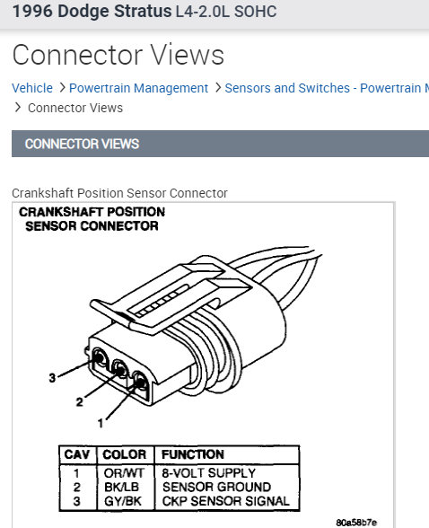

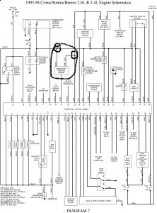

It was the crank sensor, but it wasnt that I installed it incorrectly. But when I installed it the wires must have had too much slack and it wraped around the driveshaft and ripped the sensor and all the wires right out. So now I need to find a wiring diagram to solder the wires back into place
Monday, May 10th, 2021 AT 12:23 PM
MATHIASO
  • 1,209 POSTS
Here is the diagram you requested.
I'm sending it to your email so you can identify the wires colors properly
hope this help
https://www.2carpros.com/forum/automotive_pictures/46384_0900c1528003a151_3.jpg

PEDALMONKEY120343
  • 5 POSTS

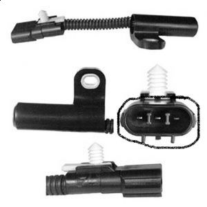

Thank you for the diagram. I couldnt really make out what it meant but I called up my dad and he explained it. But anyways, I found where the wires go and the are all puut back into place. Now I just gotta get a new crank sensor. Will a 97 crank sensor fit on a 96 stratus? I think the only difference is the flat and round pins but I got the clip for a flat pin one.
MATHIASO
  • 1,209 POSTS
The answer to your question is"yes" A sensor for a
4 cylinders 1996 or 1997 will fit, but not 6 cylinders 97
Here is the difference
4 cylinders 96-97
https://www.2carpros.com/forum/automotive_pictures/46384_0900c1528003c59a_2.jpg
6cylinders 96-97
https://www.2carpros.com/forum/automotive_pictures/46384_81_1.jpg
Feel free to ask if you have further questions, let me know your car runs after you install the crank sensor.

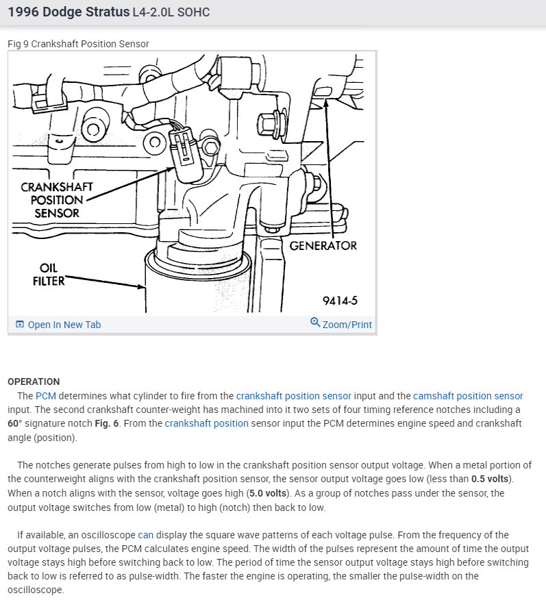

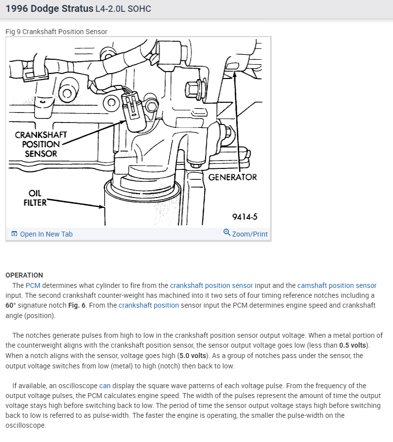

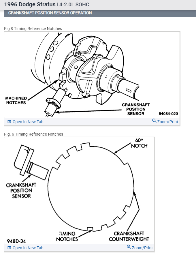

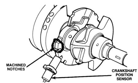

MATHIASO
  • 1,209 POSTS
The computer determines what cylinder to fire from the crankshaft position sensor input.
Visually check the connector, making sure it is attached properly and that all of the terminals are straight, tight and free of corrosion. Also inspect the notches in the crankshaft (4-cylinder) for damage, and replace if necessary
https://www.2carpros.com/forum/automotive_pictures/46384_0900c15280089880_1.jpg

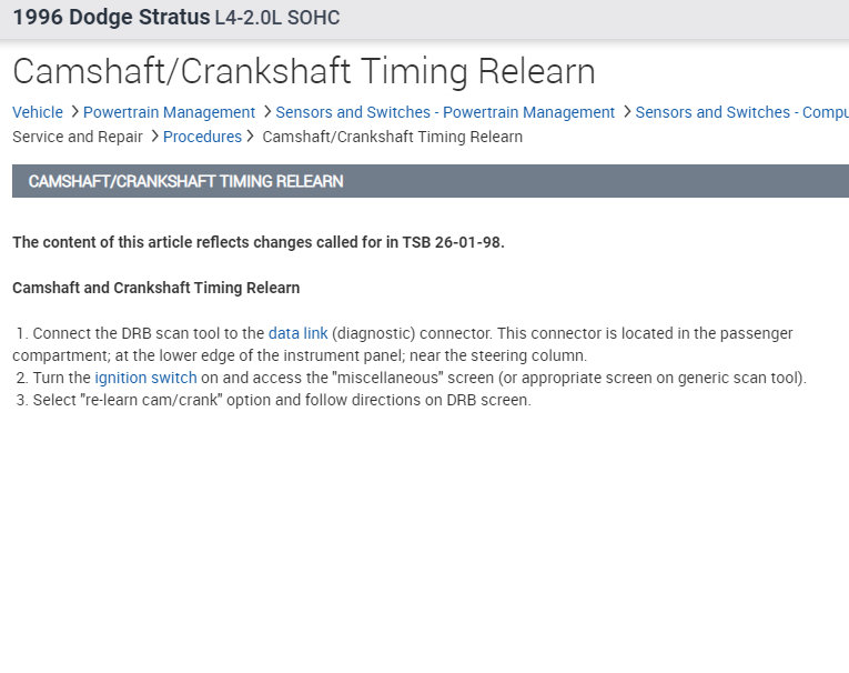

SQM
  • 6,383 POSTS
On this vehicle the new crank position sensor needs to be programmed to perform properly. The programing / learning of the new sensor will require a scan tool.
I have attached the complete crank sensor replacement guide as well as few other helpful information.
