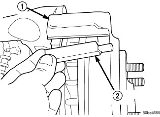

REAR
pic 1
Raise and support the vehicle (Refer to 04 - Vehicle Quick Reference/Hoisting - Standard Procedure) .
Remove the rear wheel and tire assemblies.
Compress the caliper.
Remove caliper slide bolts (3).
Pic 2
NOTE:
Do not allow brake hose to support caliper assembly.

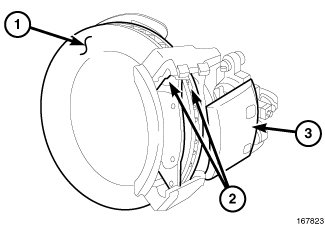

Remove the caliper (3), by tilting the top out and off the caliper adapter.

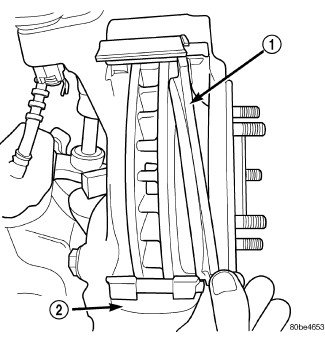

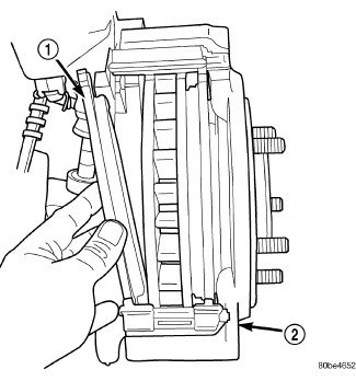

Remove inboard brake shoe (1) from the caliper adapter (2).

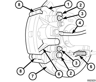

Remove outboard brake shoe (1) from caliper adapter (2).

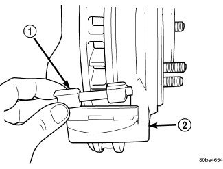

NOTE:
Anti-rattle springs are not interchangeable.
Remove the top anti-rattle spring (2) from the caliper adapter (1).

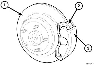

Remove the bottom anti-rattle spring (1) from the caliper adapter (2).
