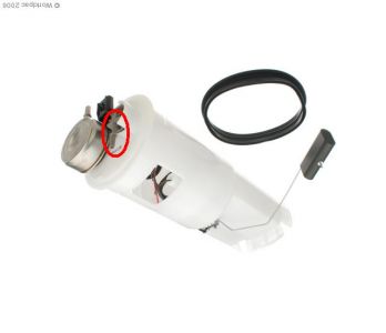

Is the auto shutoff valve located on the pump assembly itself, or just nearbye? The reason I ask is this, and it may be important, although I did not think so at the time....
The pump I bought is identical to my OEM one in every way but one: There are three connections on top of the pump. (1) Is the electical harness, and that is identical. (2) Is where the main fuel line attaches to the metal pump, and that also is identical. (3) Is a plastic nipple that stands straight up about 2 inches and this is NOT identical to the OEM pump. On the OEM pump that nipple (a) is part of a round plug that is located exactly where the new pumps nipple is, and (b) is perpendicular to the pump assemble as opposed to straight up like the new one.
The line from the truck is still attached to the new pump on the straight nipple, mind you, but there is that slight variation in the two pumps that I thought might be important.

https://www.2carpros.com/forum/automotive_pictures/99131_fuelpump_1.jpg
The part circled in red is the one in question...mine sticks straight up (I dont even know what it is..lol)

WRENCH
  • 57 POSTS
I believe that the relay it self is in with the fuses, and the pump has a plastic shut off piece fits in top of pump, that is usually swaped from old pump to new. (Maybe yours came with a new one)
