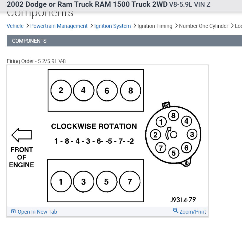

I have a 2002 dodge ram 150 4X4 5.9L engine I just replaced the distributor and I wanted to know what the timing is suppose to be set at?

NOTE: Base (initial) ignition timing is NOT adjustable. Do not attempt to adjust ignition timing by rotating the distributor.
All ignition timing functions are controlled by the Powertrain Control Module (PCM).
A DRB or equivalent scan tool may be used to verify base timing and electronic timing advance. Refer to the Scan Tool instructions for procedure.
Fuel synchronization can be verified and set by rotating the distributor.
Here is the firing order below. Check out the diagrams (Below). Please let us know if you need anything else to get the problem fixed.

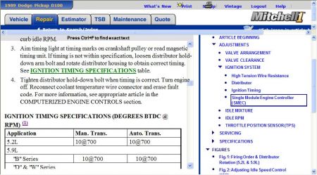

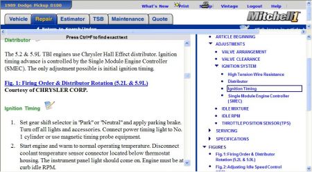

What is the proper way to set the ignition timing. How do I disable the computer and adjust the timing. My Hood tag says refer to repair manual and the repair manual says to refer to the hood tag.
Friday, November 22nd, 2019 AT 6:55 PM (Merged)
  • 75,992 POSTS
See below
