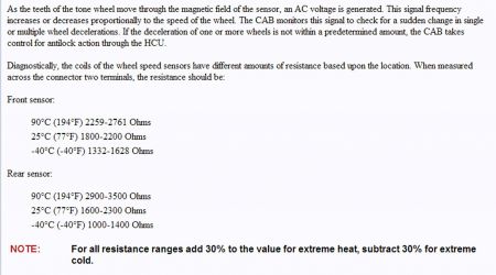

The ABS and brake lights came on while driving. Is there anything in particular to look at before taking it in?

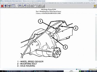

MERLIN2021
  • 17,250 POSTS
Check on the rear end, is there an electrical part on the top of the differential?
Mar 1, 2021 at 4:42 AM
BEERBUDGET
  • 7 POSTS
yes there is

MERLIN2021
  • 17,250 POSTS
I will look up the test proceedure for your RABS valve later..in the mean time see if you can get the brake codes read...usually this valve, but it's worth checking first!
MERLIN2021
  • 17,250 POSTS
Take the lead off the valve and check with an ohm meter, here are the values for front and rear sensors.
https://images.2carpros.com/forum/automotive_pictures/62217_2500RWAL_1.jpg
https://images.2carpros.com/forum/automotive_pictures/62217_2500RWALOHM_1.jpg
If you find you need to replace the valve, clean the dirt from around it before you take it out!
