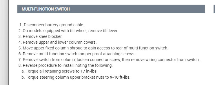

The most likely cause of this is a switch issue so let's run through this testing and then the replacement and let me know what questions you have.
https://www.2carpros.com/articles/how-a-headlight-switch-works
I am attaching the info below on this so let's run through this and let me know what you find.
Thanks
Jan 13, 2022 at 9:36 AM
JRSPANN
I changed the light switch on the dash board and that fixed my head light problem.
