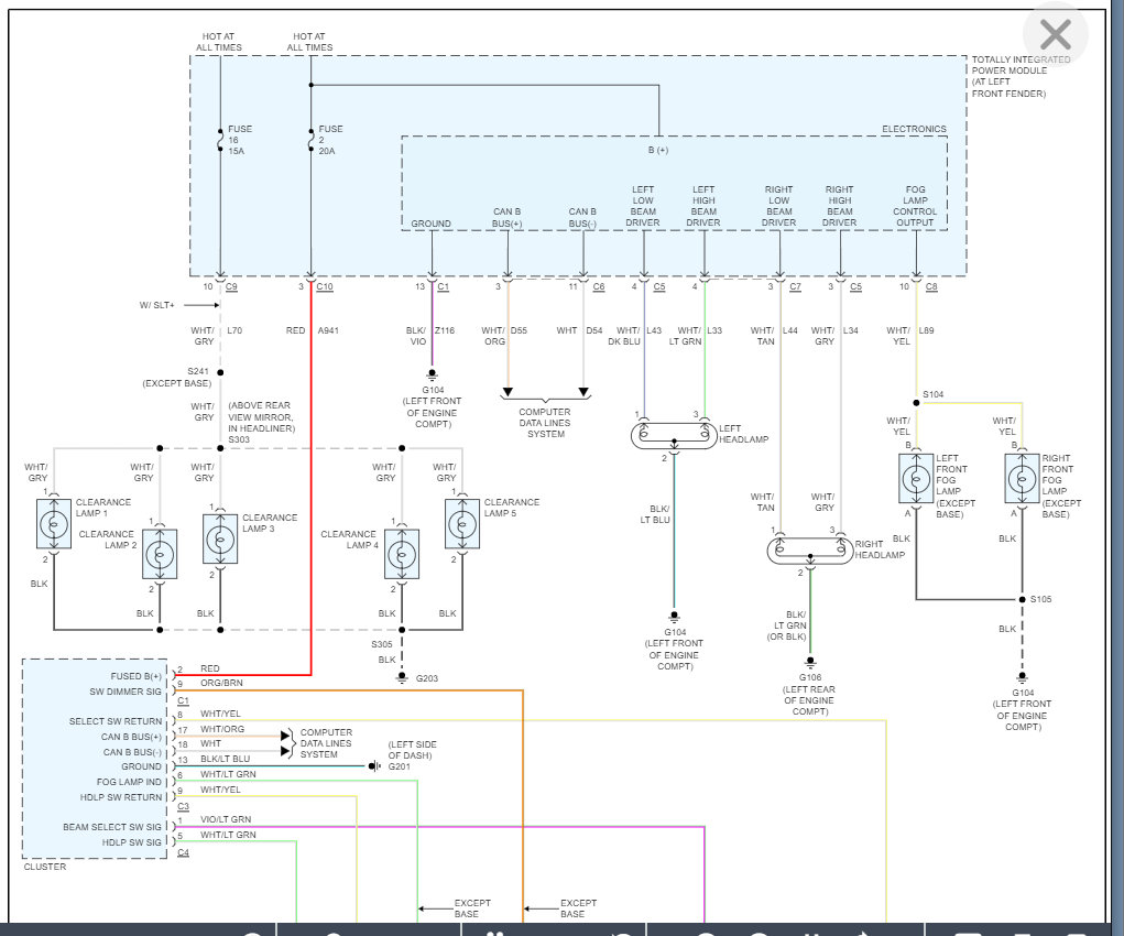

I am having issues with my headlights. My low beams work on both the driver and passenger side. However, my high beams are working on the driver side but not the passenger side. I have changed bulbs thinking that was the issue and it has not changed anything. What is causing this and how can I fix it?
Aug 7, 2010 at 3:51 PM
I can almost promise that this is the high beam driver of the TIPM has failed.
Basically, this is a fuse box that contains logic in it and is considered a module.
The TIPM has a circuit board on it that controls the low and high beams separately.
So, we just need to check the voltage coming out on the high beam driver circuit.
Please let me know what you find and what questions you have.
