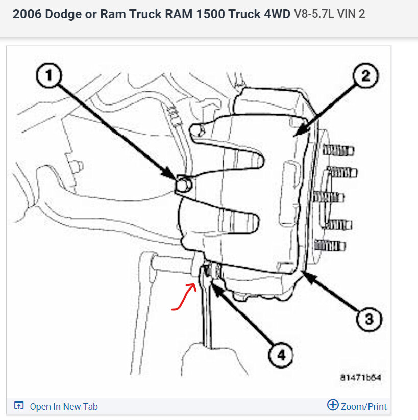

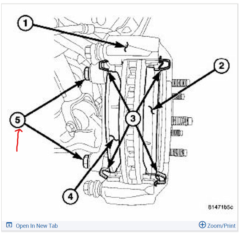

I recently changed the brake pads on the front of my vehicle. Now when I press the brakes on the drivers side I hear a thumping sound. I used a clamp to push the calibers in and did not run off the fluid. Could this have damaged the anti-lock system? If so is this going to hurt hurt to drive in the near future until I can get it checked by a mechanic? Is there anything I can do to fix the problem?

Thumping sounds can be you got grease on part of the brake rotor, or the rotor is not true due to rust on the bearing hub before you installed it, please go over this guide which can help you:
https://www.2carpros.com/articles/how-to-replace-brake-rotors-correctly
Also, I would check the caliper mounting bolts to make sure they are tight. Check the diagrams below so you can see what I am talking about. Check out the images (below). Please let us know what happens.
