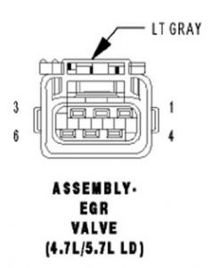

According to my information, there is one. However, the only thing I could find is the wiring harness to it. Here is a picture of that at least:
https://www.2carpros.com/forum/automotive_pictures/249084_aaa_2.jpg
I do not know if it will help, but it may give you an idea as to what you are looking for.
Let me know what you find.

Okay, I have looked up a EGR valve for my truck at Advance Auto, and O'Reileys auto parts, and even at Dodge, and cannot find one, lol. I cannot even find the wires to it. Could it be called something else than EGR? I know what the word EGR stands for but maybe Dodge calls it something else. I am still looking for it, and looking on sites as to where it is. Some say its under the alternator, and some say it is on the driver side at back of motor? At least I know my engine now, lol. I have been all over that silly thing. I will keep looking, and if you know of anything else let me know thanks. Oh yeah, it is a 2003 Ram 1500 4.7 liter two wheel drive automatic if that will help any more.
Thanks man
-1
Tuesday, April 20th, 2010 AT 3:12 AM
  • 109,885 POSTS
That is what I looked up. Interesting that I could not find the part either but only the wiring. If it has one, it will be on the intake. Let me know.

Hey Joe, I looked all over the engine for the EGR valve and even called the dealer. They told me that some of the rams have an EGR valve and some do not! I did change the fuel filter or I should say the the pump and filter all one unit. The only other thing I can think it might be is one of the coils. I put a MAP sensor on it also, and all that I have replaced it still acts up so the only thing left is the coils I hope that takes care of it. Or maybe the EVAP? Heck I do not know, lol. I am about to go crazy.
Thanks for your time.
Tuesday, April 27th, 2010 AT 5:27 PM
  • 109,885 POSTS
I would say you have exhausted everything other than a coil. Let me know what you find. If you have luck like I do, it will end up being a vacuum leak. As far as the EVAP system, I do not think it would cause this type of problem.
