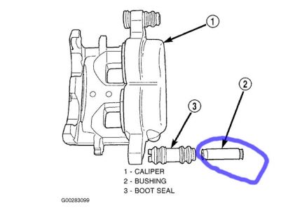

What did you torque the axle nut too? IF this were mine, I would look close at the brakes. May not be the source, but they are admittedly bad. Frankly...For the vast majority, Rotors are no longer machinable....and still functionable. If you need em, replace em. When if it doesn't solve the problem. Fair chance it will. Get new pads too. THey both need a flat surface to meet . Look at the bracket..It there wear into it or is it flat so pads can slide? https://www.2carpros.com/forum/automotive
_pictures/30961_cal1c_1.jpg Any grooves..replace it. The pins, boots and caliper holes are often a problem if they don't work together.
https://images.2carpros.com/forum/automotive_pictures/30961_cal1_2.jpg

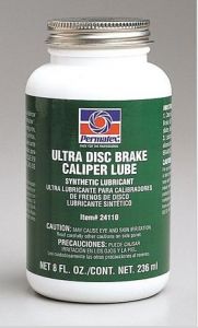

The pins MUST be clean and well lubed.
https://images.2carpros.com/forum/automotive_pictures/30961_caliper_lube_24.jpg

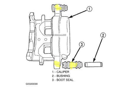

Very often with these it the corrosion builds up behing the boot in the caliper hole the boot sets in. It swells and the pin can't move.
https://images.2carpros.com/forum/automotive_pictures/30961_cal1a_1.jpg
The Pin MUST move freely. The pads must move freely. MAke sure the caliper is installed so that the hose is not twisted but, relaxed.

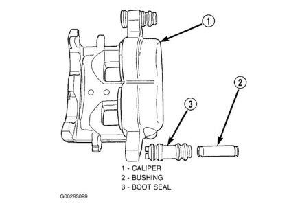

Nov 3, 2010 at 1:55 PM
SERVICE WRITER
  • 9,123 POSTS

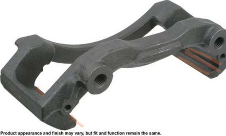

If there is any resistance in the pin movement, remove the rubber boot carefully or replace them. You will not likely be able to just pull it out unless you separate it from the caliper with a dull screwdriver or similiar. Ream out the hole that the boot sets in with a plumber's wire brush, die grinder or what ever you have to clean it out, apply a thin coating of lube and reinstall the boot. Wire wheel the pin and lube it. It should now move freely. IF there is any pitting on the pin, replacement is best.
https://images.2carpros.com/forum/automotive_pictures/30961_cal1b_1.jpg
These surface need to be clean, flat and lubed as well. ANy divots from wear will trap the pad preventing movement.
https://images.2carpros.com/forum/automotive_pictures/30961_cal1c_2.jpg
This may or may not be your source, but is where I would go to at this point.
