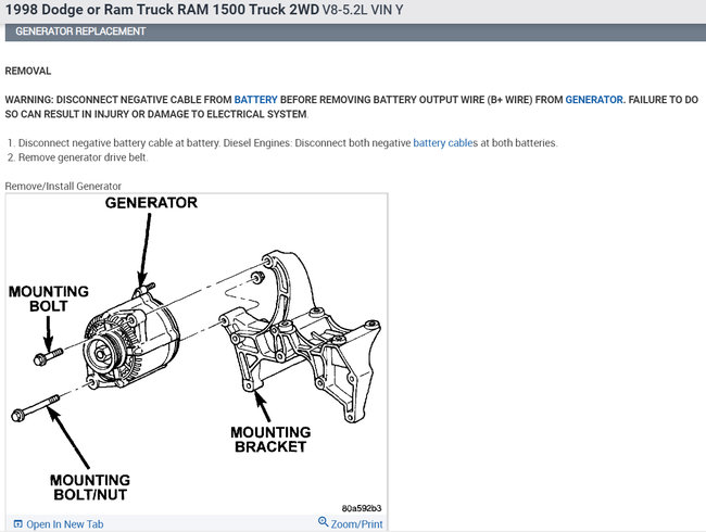

Had to jump start my 98 dodge ram 5.2l. Battery only 2 years old. After starting, I let off gas and everything dies, lights, everything. Is it alternator or idle air control?
Monday, June 29th, 2009 AT 11:29 PM
KEN L
  • MASTER CERTIFIED MECHANIC
  • 48,543 POSTS

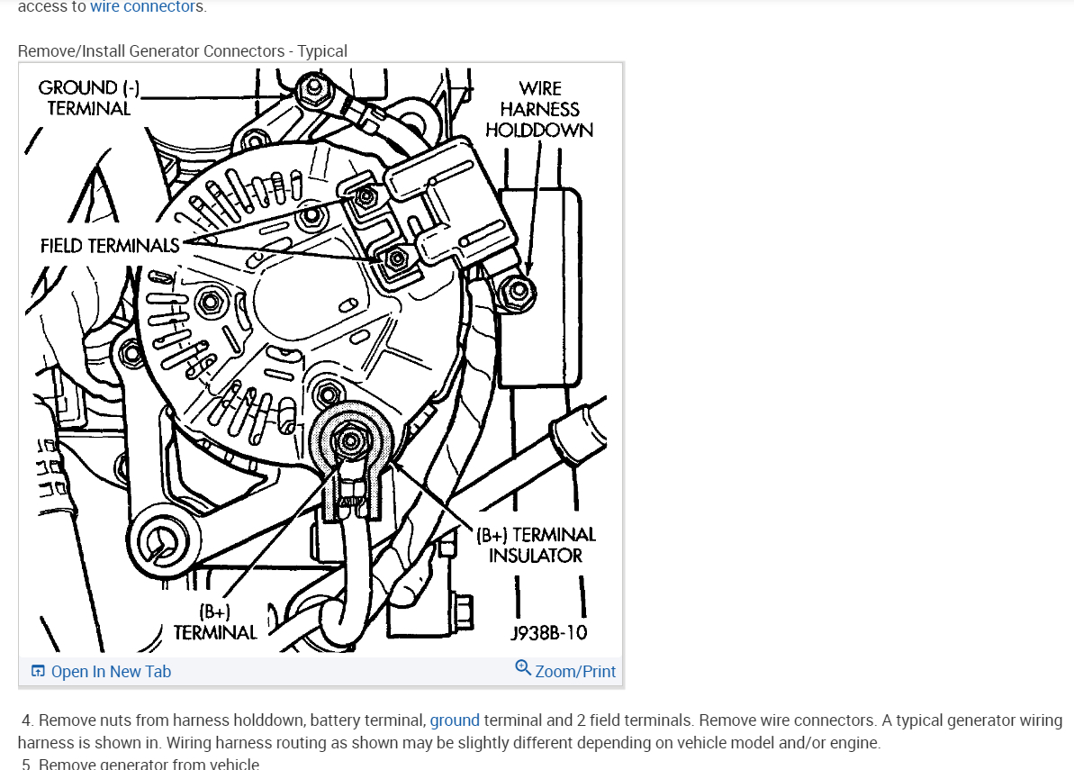

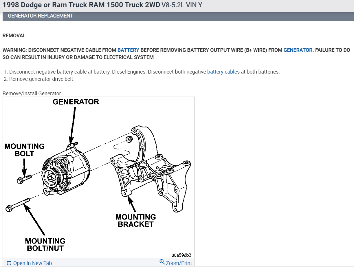

It sounds like it could be both, I would check the alternator output and then replace it if it is not changing. This guide can help, and I have left diagrams below on how to change the alternator out. Disconnect the battery first.

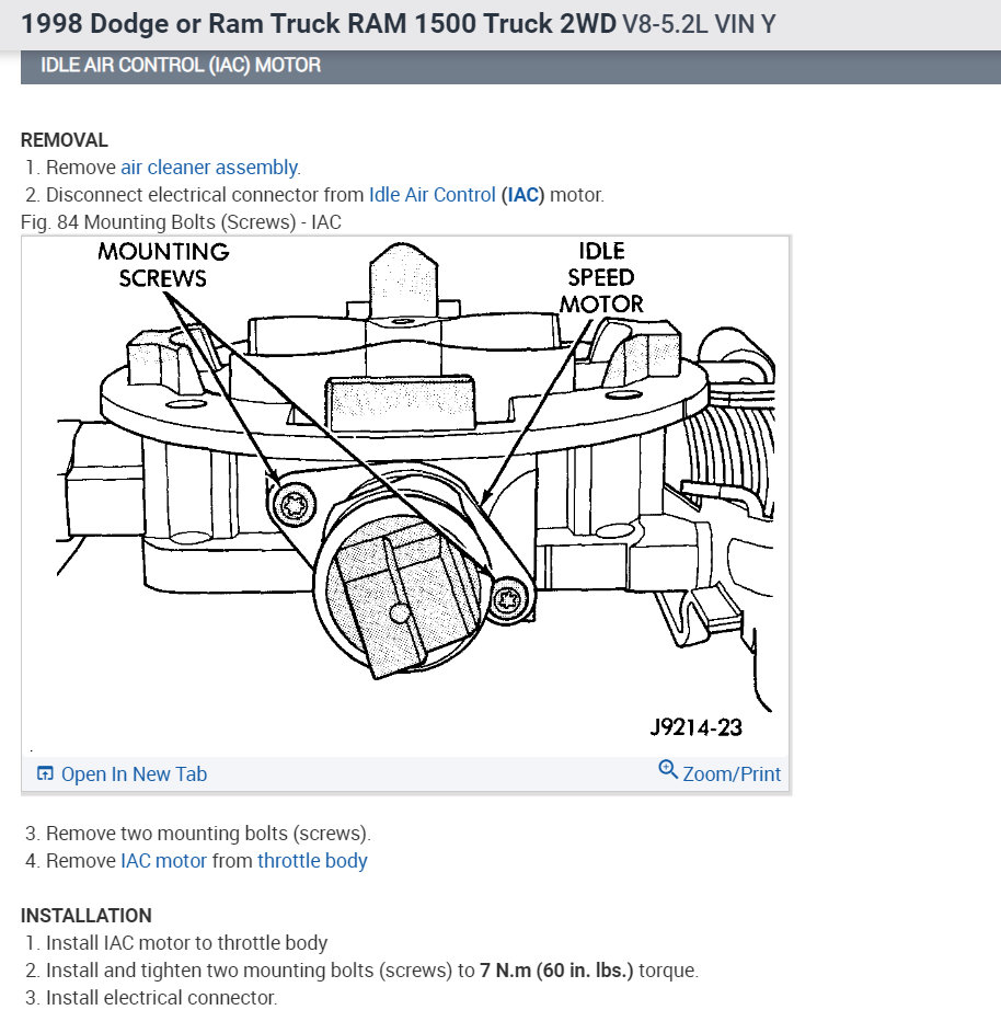

Also, for the stalling at idle problem the IAC sounds like it is dirty or not working correctly. The location is in the diagrams as well.
https://www.2carpros.com/articles/idle-air-control-valve-service
