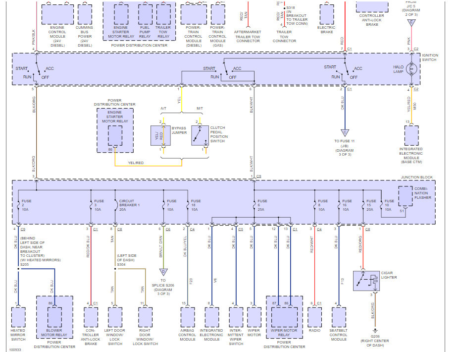

My interior lights, radio, power side mirrors, and power locks do not work. When the key is in the ignition the power door locks only open they do not lock. I replaced the timing module, and checked the fuses. I heard the the ignition switch might have something to do with it. I already check the fuse and the relays under the hood. I want to know if that was the problem or if anyone had any ideas that could help me out.

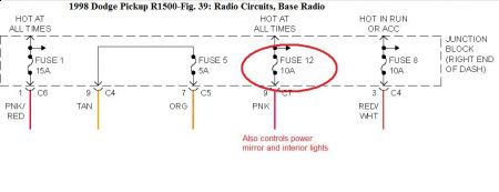

If all interior lights, radio and power mirrors do not work, you need to check fuse #12. Everything is run through that fuse.
https://images.2carpros.com/forum/automotive_pictures/55316_98ramradio_1.jpg
As for the door lock, try cleaning the solenoids using some electrical cleaner. Over time, you have a lot of buildup in the solenoid. I had to replace two solenoid in my wife's car because of that.

Hello, did you check the fuse circuit for voltage, even if the fuse is good, if there is no feed it won't matter.
Fuse 12, 10 amp for radio and dome lite, should be hot all the time.
Did you check that the fuse circuit has voltage? Zackman posted a diagram, did you check that fuse box. I think it could be the ignitions witch because I looked at the wiring diagram and if one leg of the switch is not working it will cause this problem.
Here is a guide and the wiring so you can confirm the failure test the black and orange wire.
Check out the diagrams (below). Please run this test and get back to us.
Cheers
Mar 12, 2009 at 12:19 PM
ASCAMARORSSS
  • 5 POSTS
Yep, that was the problem I run the test and found no power coming out of the switch so I replaced it all fixed! Thanks for your help I love this site.

Check for power on connector C1 terminals 6 red/white wire 7 pink wire.

Check fuse # 12 in box end of dash a 10amp.

FYI. I got the fuse out, the #12 fuse, as you instructed. The fuse was blown and I now have power/current to the pink wire as well as the red with the white tracer. Thank you so very much for your guidance, instruction and input. Just so you will know. There are a total of three fuses in my fuse box that have some type of plastic cover or, kind of like a clip over them. Two of them, I cannot remember what they serve or what number. They are are right next to each other and have identical yellow clips or covers over the fuses. The other one is fuse number 12. But it has a black clip/cover. I pulled hard with a pair of needle nose and it finally came off and brought the red, 10 amp fuse with it. The fuse was down inside of the clip and the clip had two long legs, about 3/4 of an inch that reach down into and seat into holes/slots in the wall of the fuse panel. I have no idea why 12 has this cover. I am not sure if I was able to convey the description very well, but wanted to try. It was a bit confusing and baffling. But, again I replaced the fuse and now have power and once again thanks so much!
