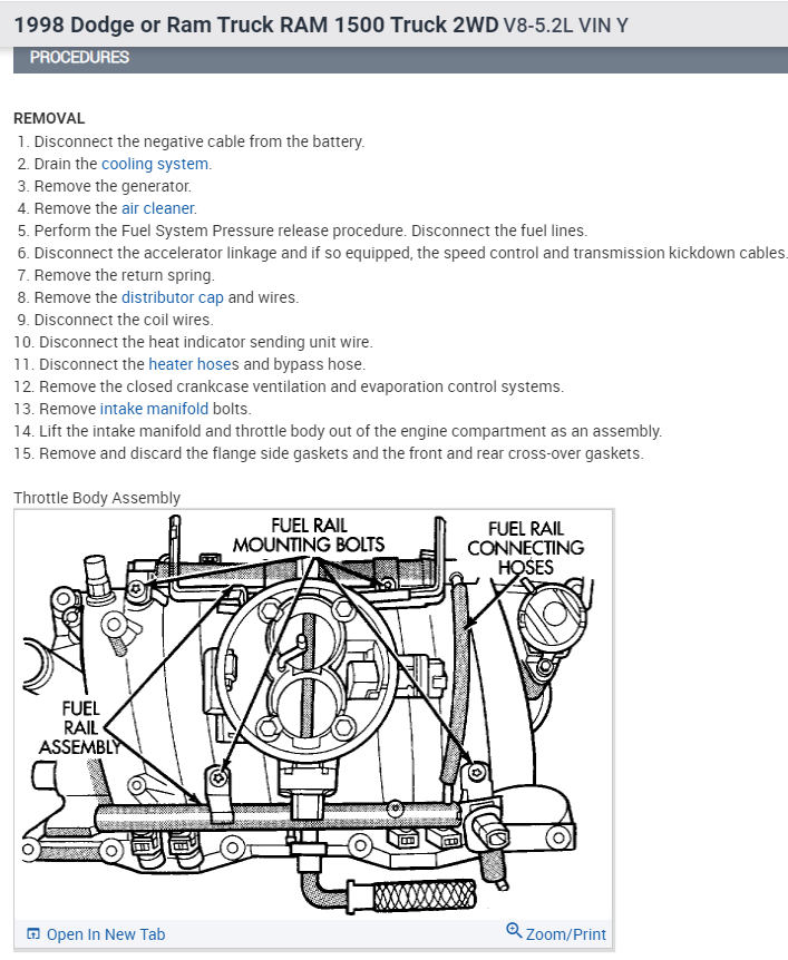

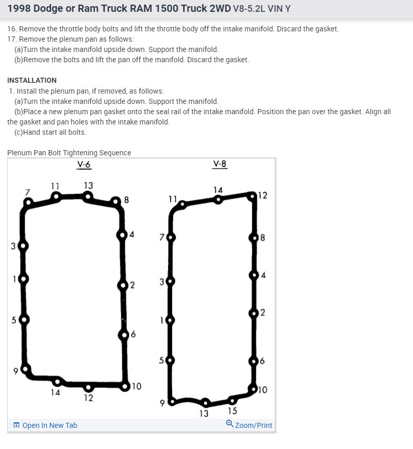

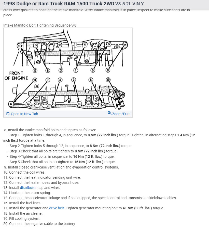

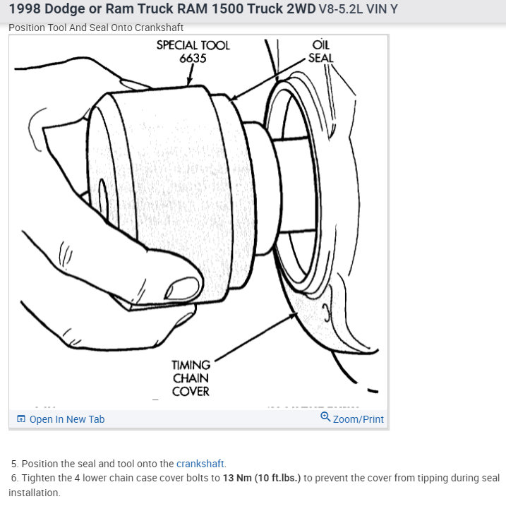

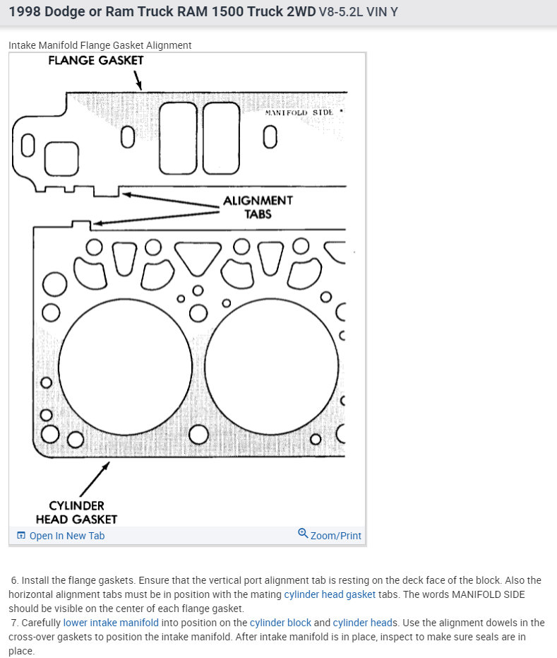

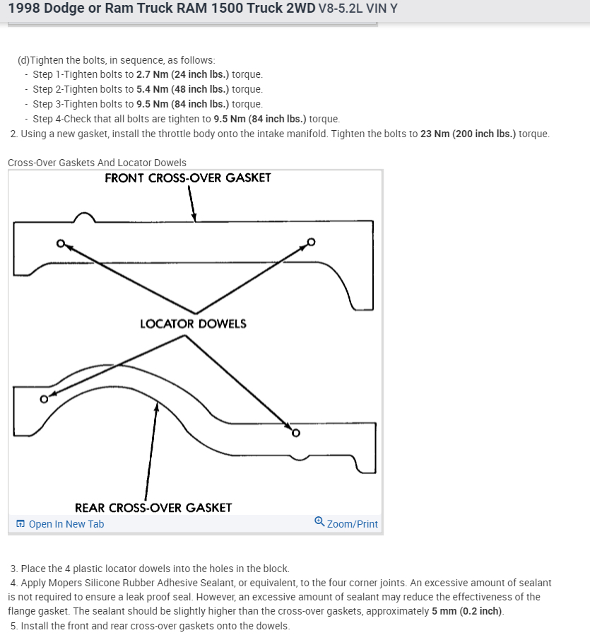

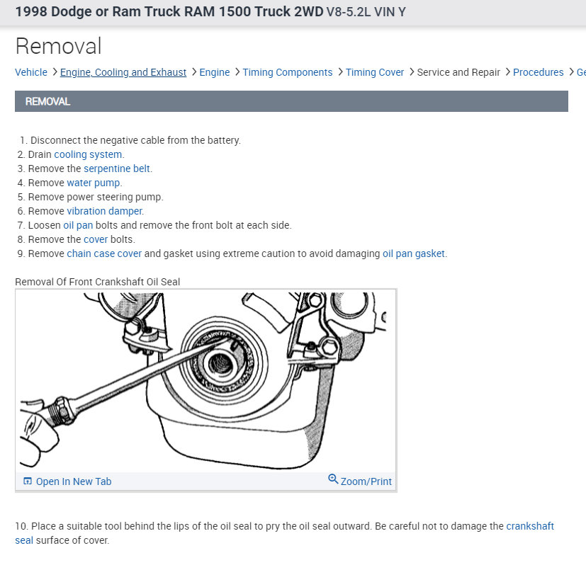

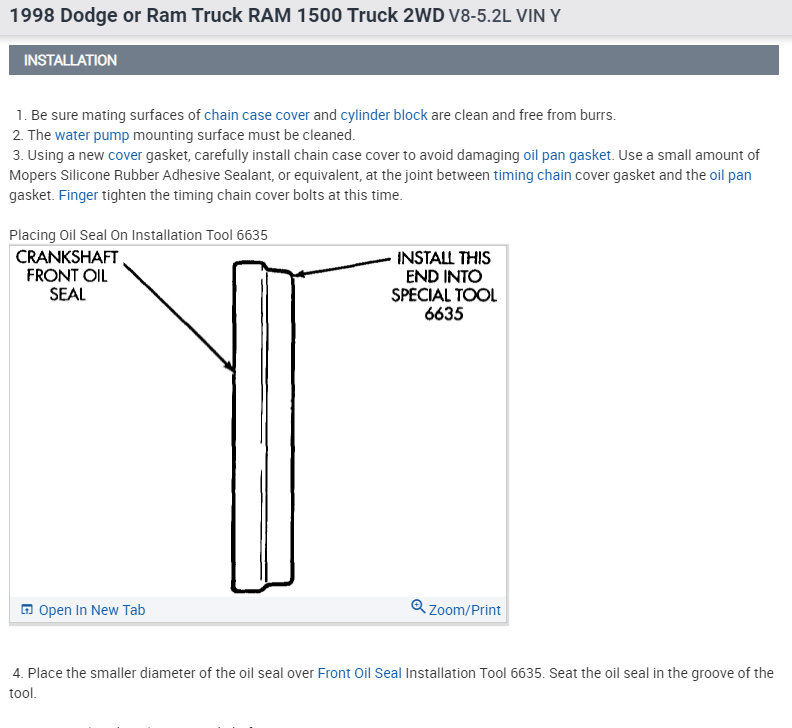

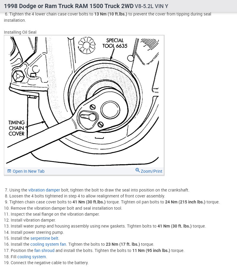

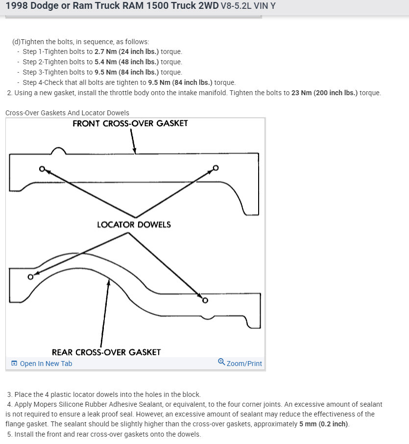

I have attached the replacement procedure for the intake gasket and timing cover below for your reference.
