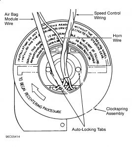

i am not getting power to my switch i checked and rechecked the fuses and checked in the hand book and cant find a thing about cruse control i even went out and bought another control modual that mounts on the steering wheel and it still dont work i have tilt steering and might there be a wire broke from tilting it back and forth and if so how do i fix this please advise thanks pete e-mail thetitan2@comcast.net

Does the horn work all the time do you have an air bag light coming on most common failure is the clock spring ***************************************** need manual CHECK IT @ https://www.2carpros.com/kpages/auto_repair_manuals.htm
https://images.2carpros.com/forum/automotive_pictures/99387_Graphic1_364.jpg
