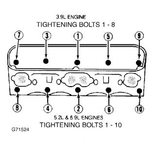

1989 Dodge Ram cylinder head torque sequence
1989 DODGE RAM
GENIRAYM
1989 Dodge Ram 6 cyl
what is the cylinder head torque sequence
Jun 18, 2010 at 4:39 AM
DOCFIXIT
  • 18,828 POSTS
Ft. Lbs. step one 50 , step 2 105 see diagram
https://images.2carpros.com/forum/automotive_pictures/198357_Graphic_489.jpg
