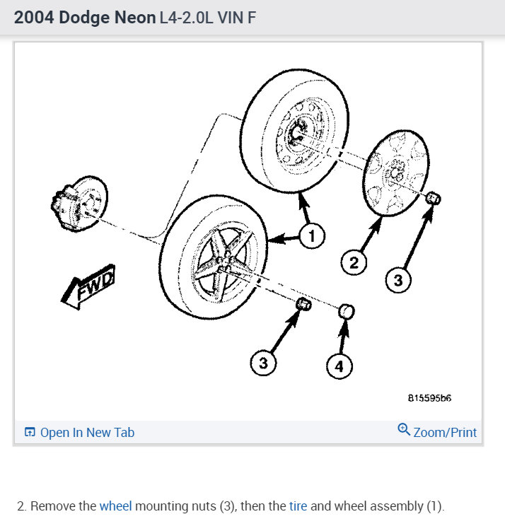

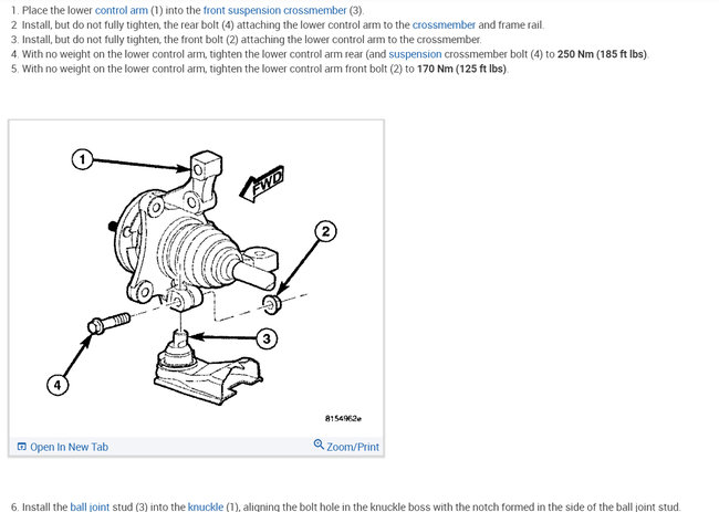

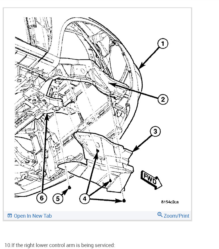

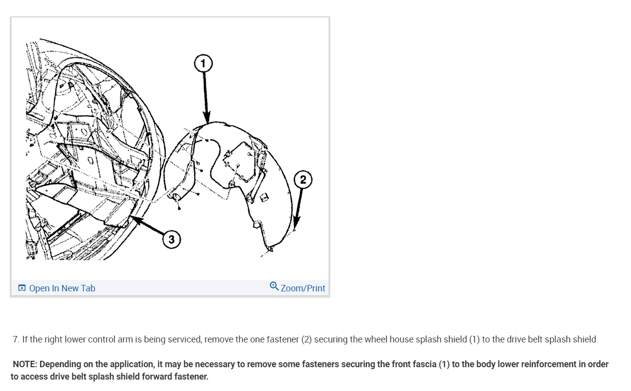

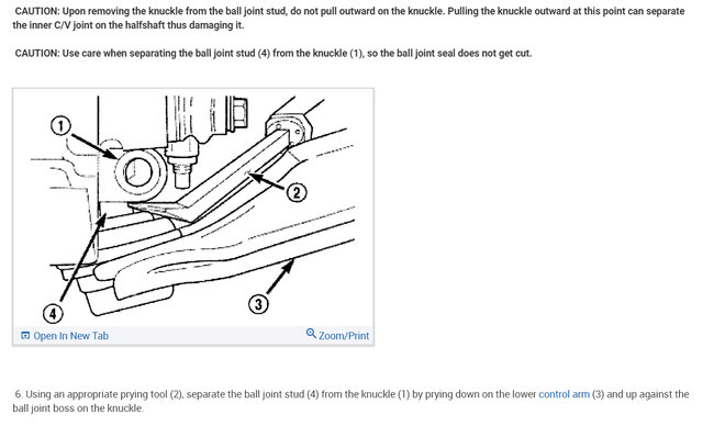

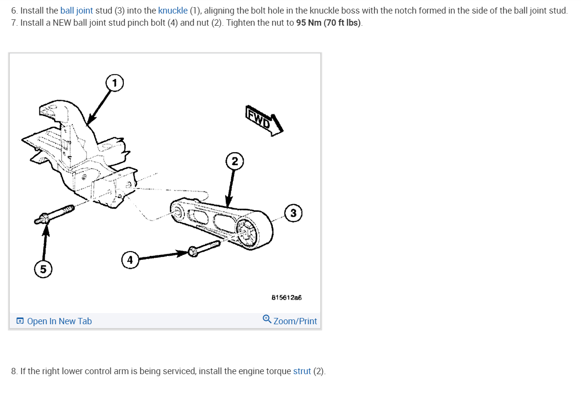

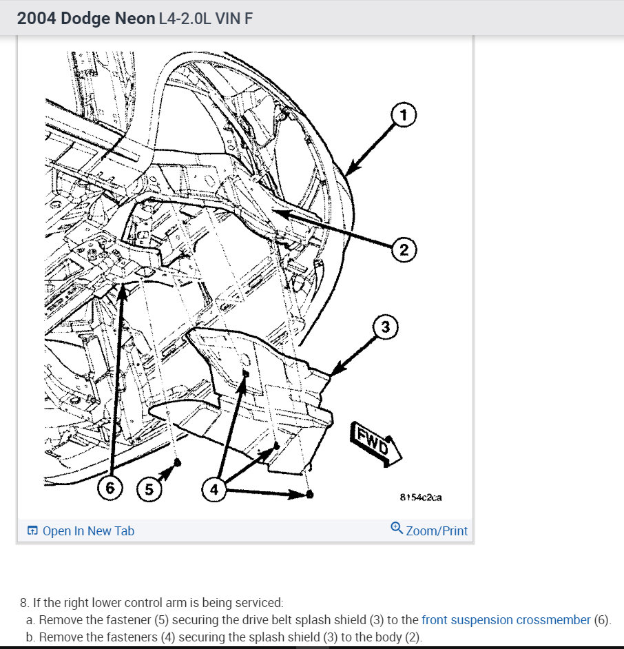

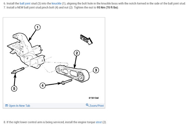

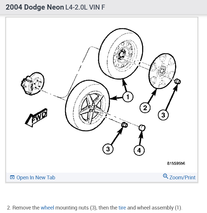

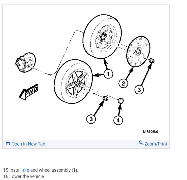

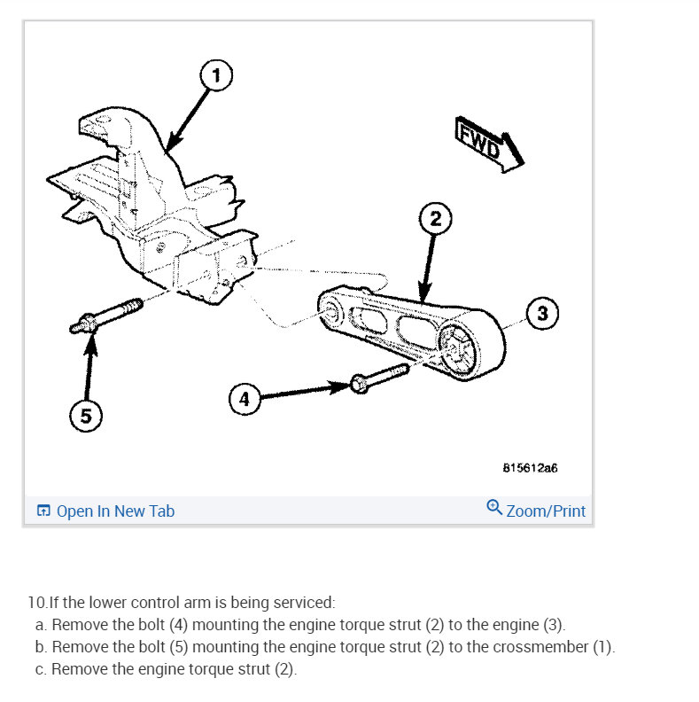

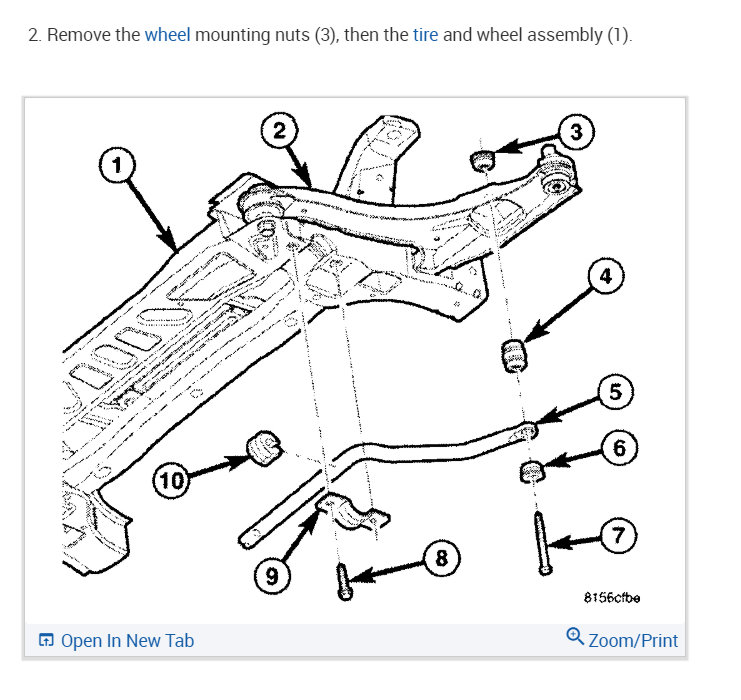

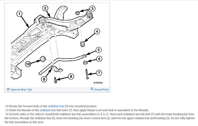

I am always repairing something and now my bushing are going out and my lower control arms have to be replaced at only 38,000 miles. How hard is to replace this part and can you find the parts cheaper than 350.00 a piece?????
Sep 12, 2007 at 4:51 AM
MERLIN2021
  • 17,250 POSTS

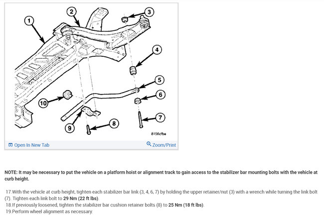

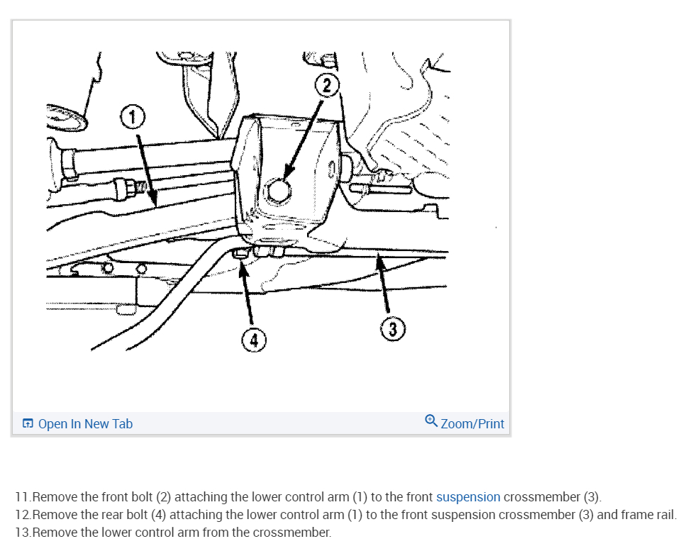

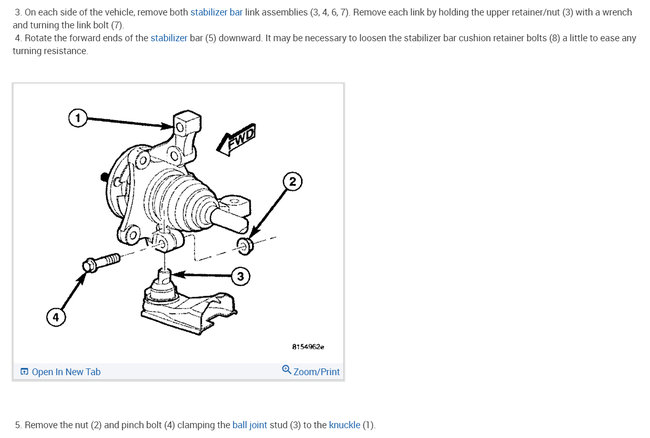

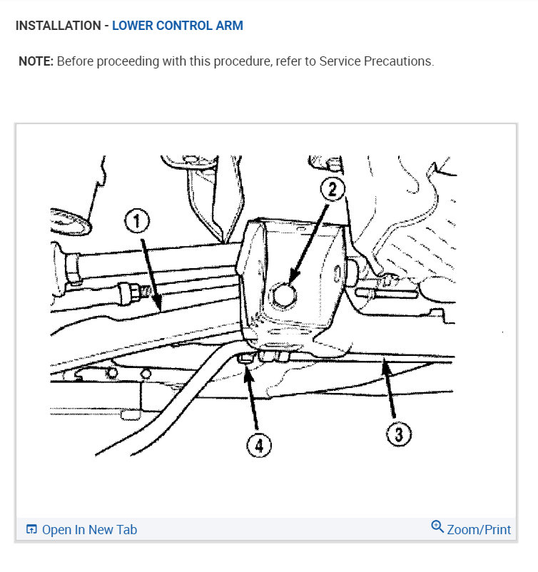

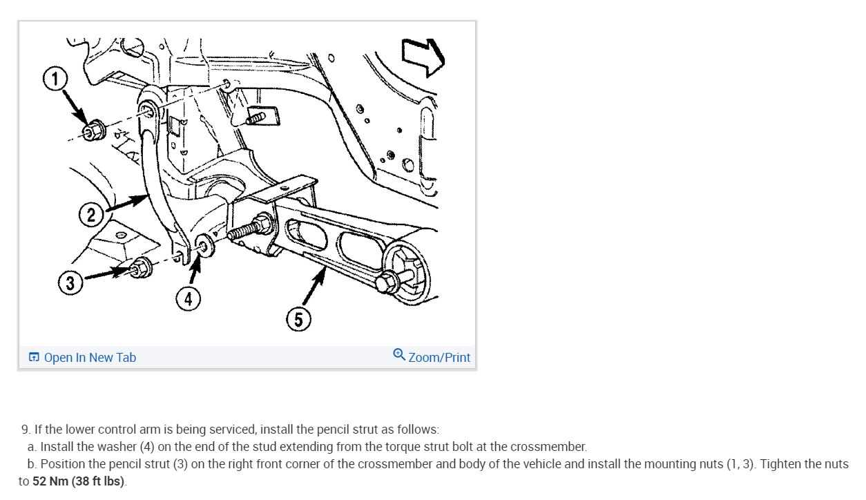

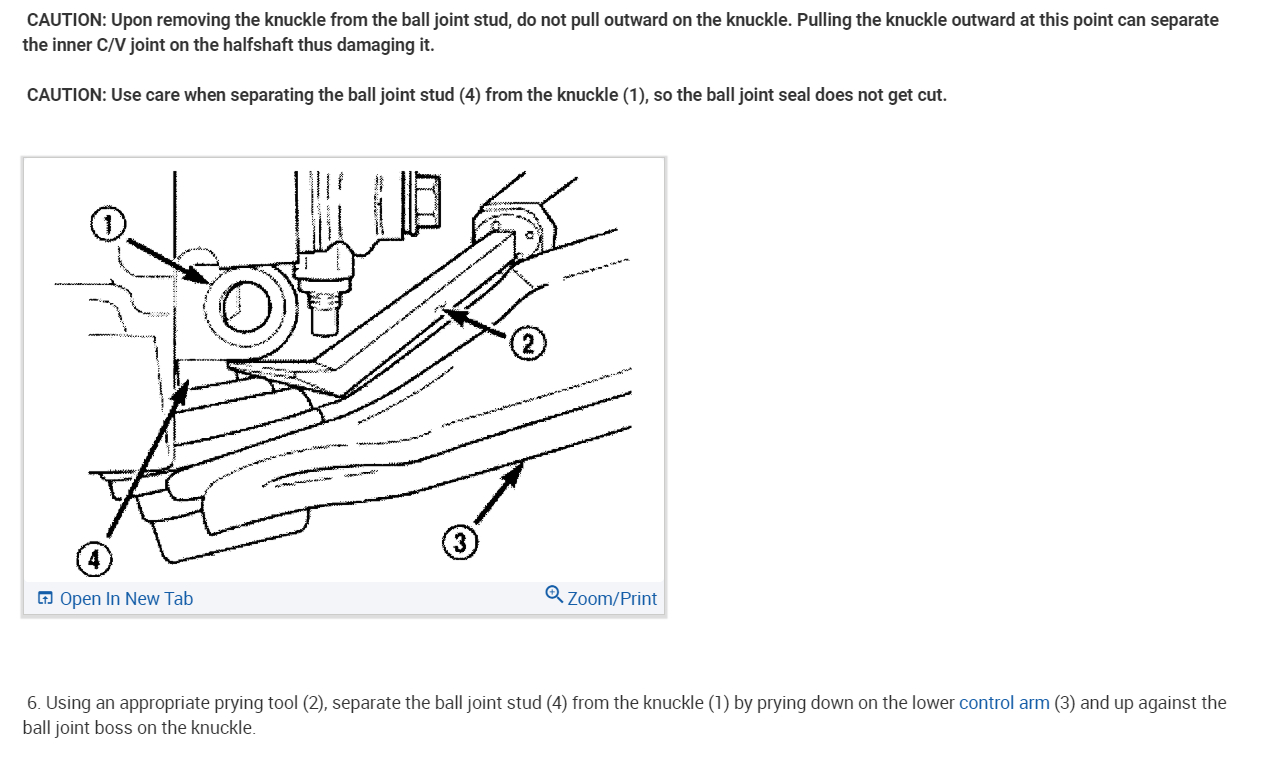

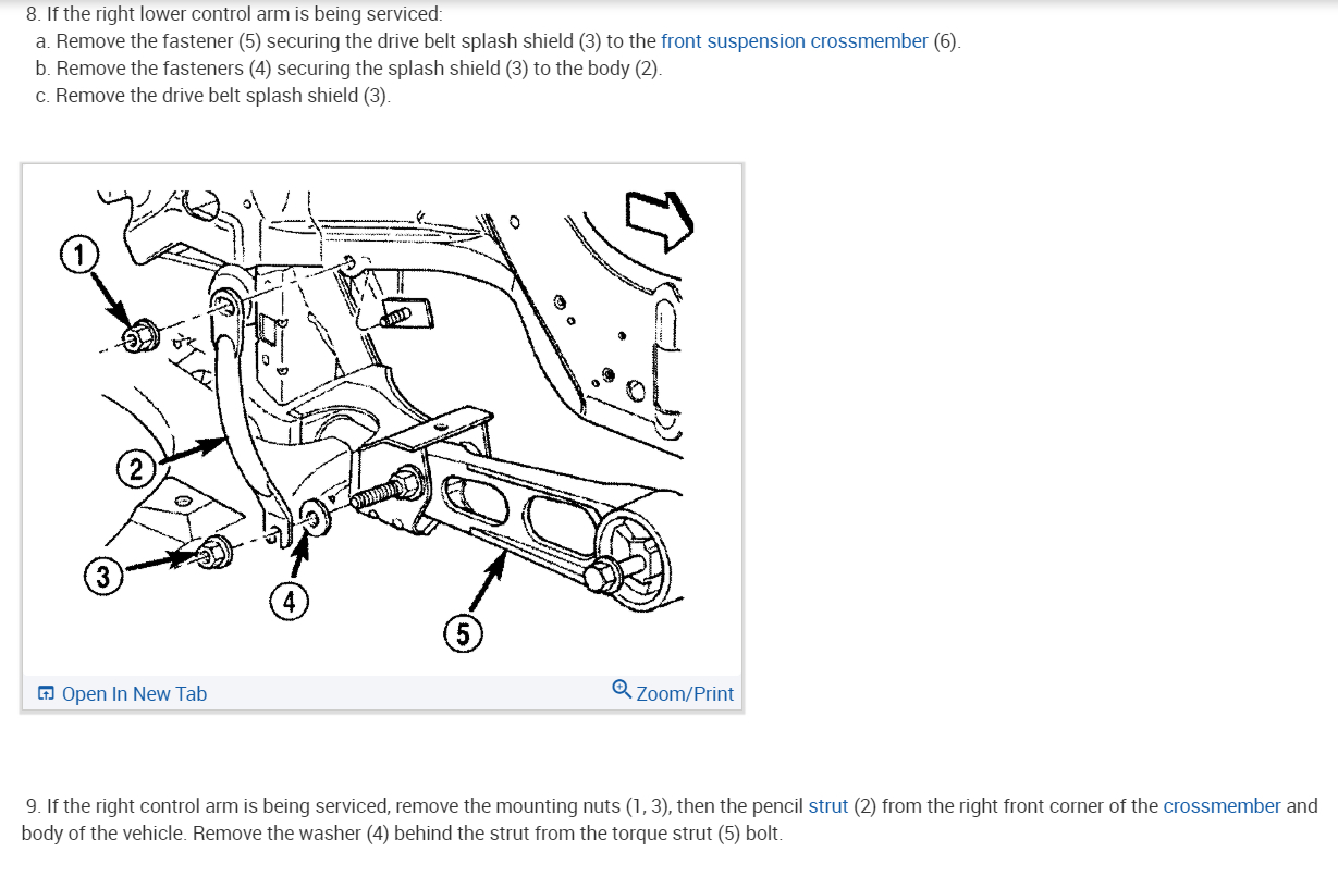

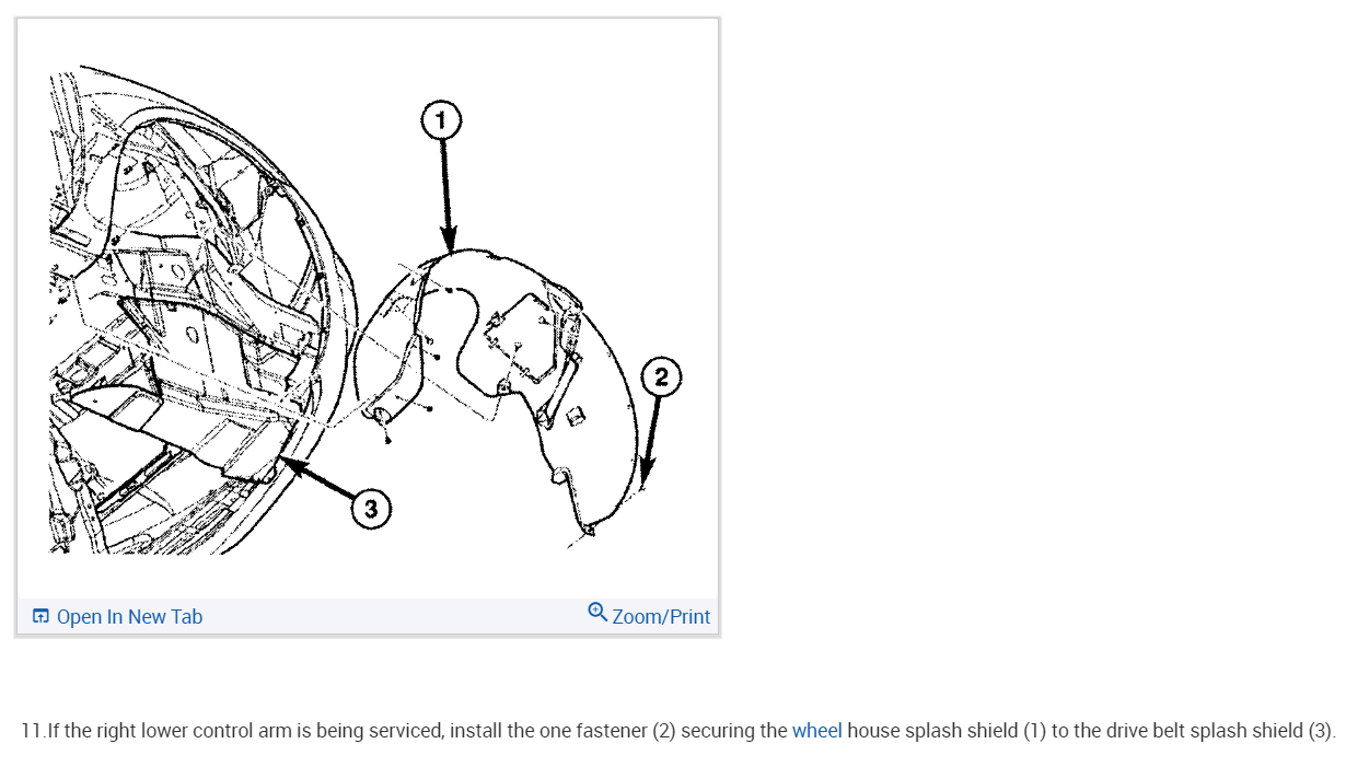

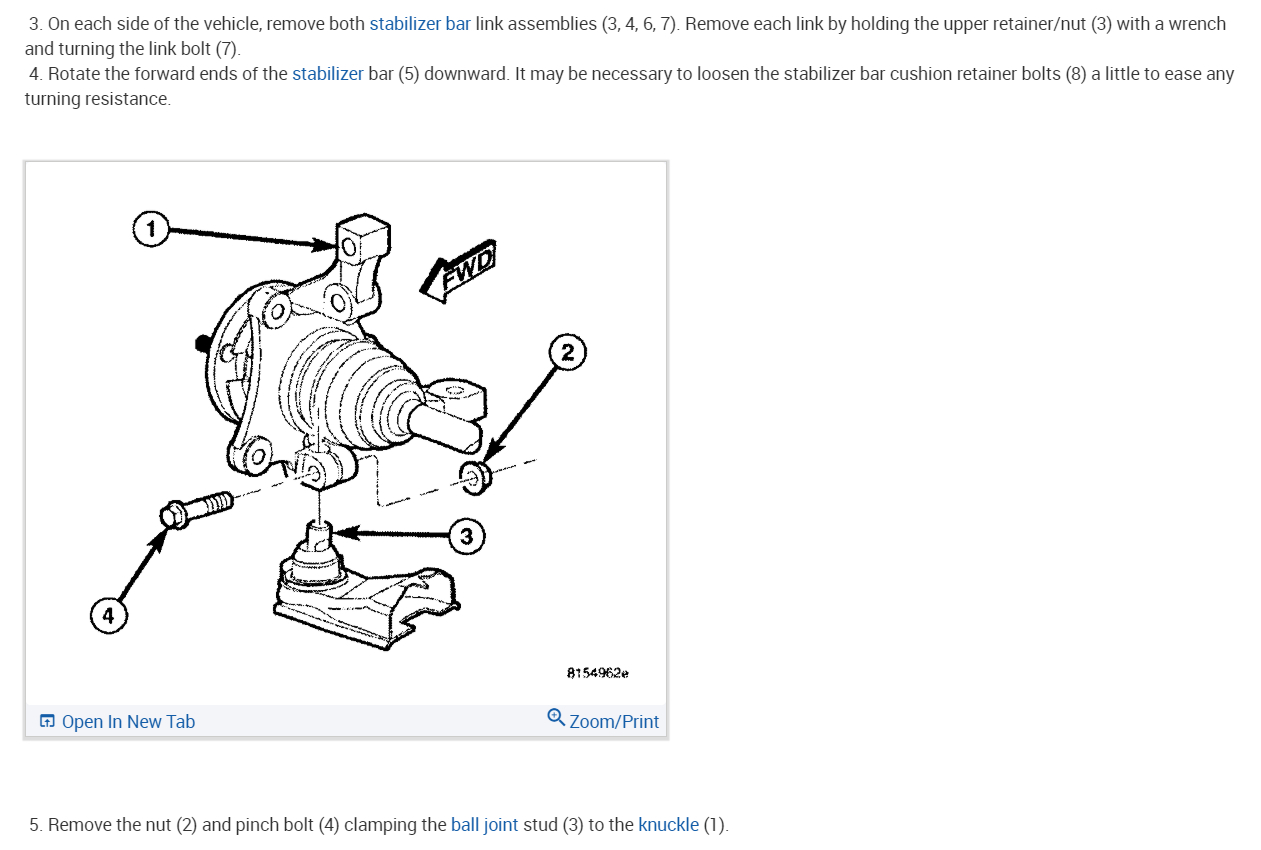

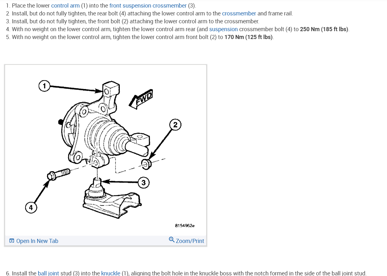

I show 75.00 including arm and bushings...I would say 38,000 on a lightweight car like yous is pretty lousy! If you have air tools and good jack it won't be too bad. Here are the instruction in the diagrams below. Check out the diagrams (Below). Please let us know if you need anything else to get the problem fixed.

PORIDNECK
can remove the front horizontal bolt, only have access to the rear the nut side, I can turn the nut but wont be able to hold the head of the bolt or remove, it is enclosed in the frame.
May 2, 2020 at 4:09 AM (Merged)
HMAC300
  • 48,601 POSTS
the only way to do this when that happens is to cut ahole to access it then reweld the frame back where hole was cut.
PORIDNECK
yes this is what I thought just wanted to make sure before imessed up, thanks for your help.......

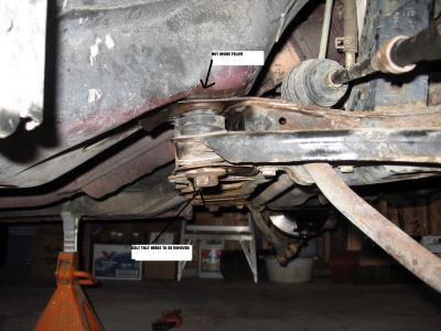

MAERC
While trying to remove the bolt to replace the passenger side lower control arm, the nut that's welded inside the frame broke loose. It's boxed inside the frame and rusted to the bolt, so the bolt just spins. How do we get the bolt out, short of cutting a hole in the frame big enough to get a wrench in?
https://images.2carpros.com/forum/automotive_pictures/215656_c_1.jpg
NEONCOREY
Did you ever get this fixed with out cutting the frame and what not?
I am changing the bushings currently and i am using a 1/2" torque wrench with a pipe for more leverage and I am 2 secs from snapping the bolt it feels.....both sides are just as tight. 1/2 inch air gun isn't touching it so we resorted to the pipe on the end of a torque wrench and got it about 1/4 of the way out but now I am hitting a wall as it is so tight i think it might snap the bolt.
There has to be a trick....i don't want it to snap and have to cut the frame and everything.....any help would be greatley appreciated.
Thanks Corey
CARADIODOC
  • 34,321 POSTS
These nuts have a strip of metal spot welded to them to act as a wrench. That's what breaks loose and lets the nut spin. When you do manage to get the bolt part way out but then it gets tight it's because rust on the threads is getting inside the nut. Any professional would stop instantly, apply a spray lubricating grease, then run the bolt back in to bring the grease into the threads in the nut. Continuing to try to unscrew a bolt that gets tighter and tighter is just asking for disaster.
The trick is to reach inside the frame opening with a wire feed welder to tack the metal strap back onto the nut. As soon as that is done, you turn the bolt before the nut has had a chance to cool. As the nut cools and shrinks, the bolt will get harder to turn. At that point, you can reheat the nut with a small flame from an acetylene torch to expand it. Don't waste your time trying to do this with a propane torch. The flame is way too big, the temperature is too low, and you'll just make the nut mad!

THATKIDDEEJAAY
I am changing the control arms on my car, and I was putting things back together and I cannot get the lower rearward bolt in. (Front- Driver side, Rearward bushing)
Thank you!
May 2, 2020 at 4:17 AM (Merged)
WRENCHTECH
  • 20,761 POSTS
Make sure the ball joint is not connected and the other bolt is loose. You need the arm to remain loose and free to get the holes to line up.

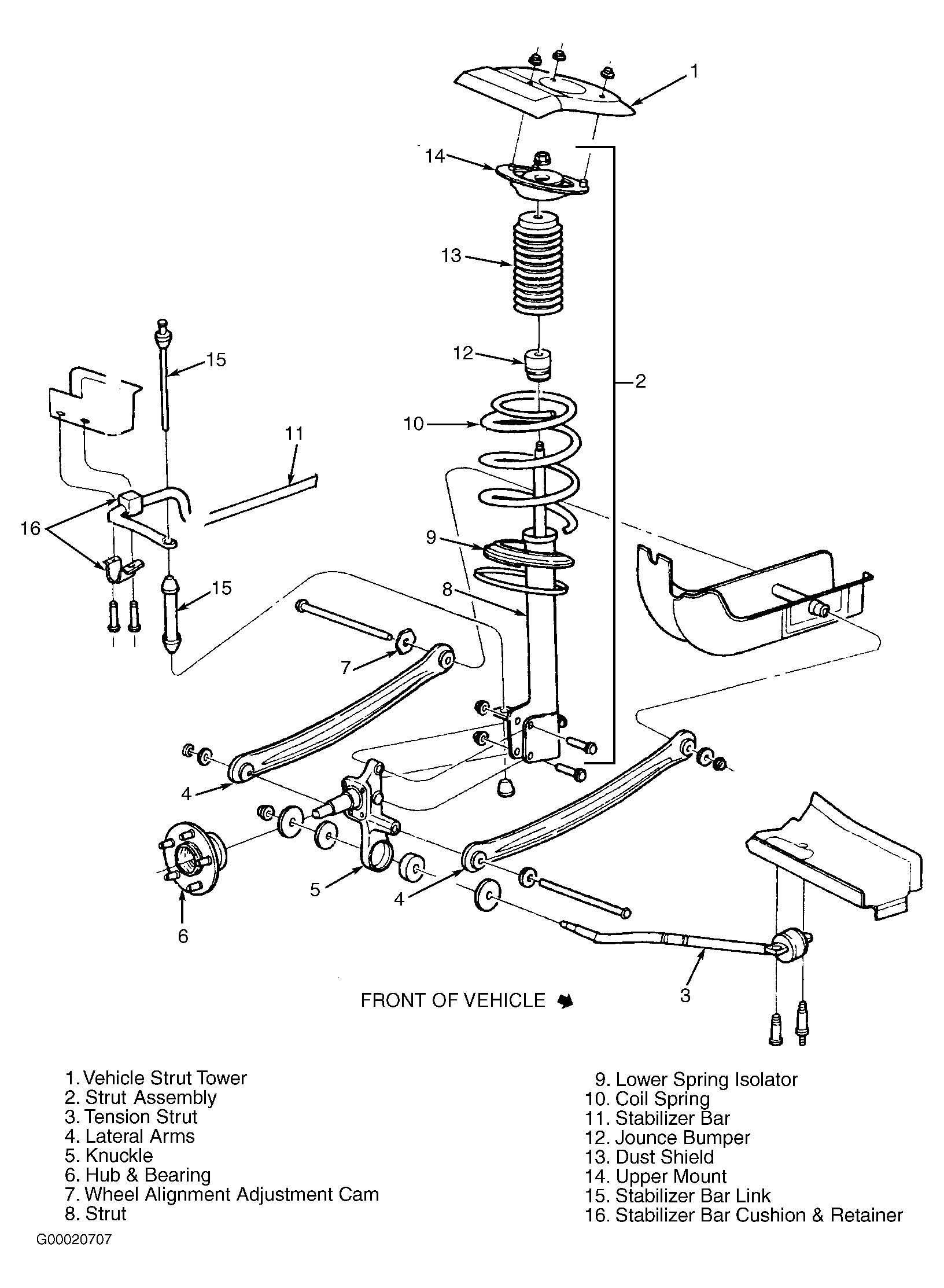

CSWANSON
does anyone have the schematic for a 2000 neon, I am trying to ID all the control arm components, the sway bar components, and trailing arm. Need new bushings but not sure of all the components.
Thanks
DOCFIXIT
  • 18,828 POSTS
how's this?
CSWANSON
Perfect! Thanks for the quick reply.
I am trying to find the bushings for #4 Lateral arms, hard to find.
Thanks again,
