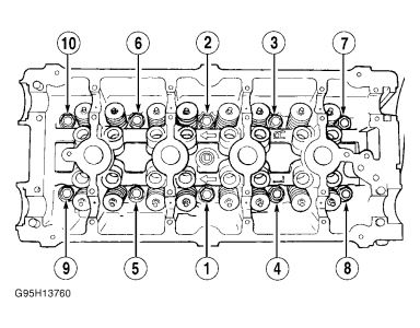

hi, I am trying to install a head on my 200 dodge neon. it has a 2.0 ltr engine and 128,000 miles on it. i am having trouble trying to find out the order to torque down the screw and what to torque them at. i know that you have to torque tem down in a certain order at one number of lbs. first and then go back and torque again at the last lbs. setting.

Three step process 1. 25 2. 50 3. 50 4. Do not use a torque wrench on this step! Turn an additional 90 degrees.
https://images.2carpros.com/forum/automotive_pictures/62217_NeonSeq_1.jpg
https://images.2carpros.com/forum/automotive_pictures/62217_30961_mitchell_2_22.jpg
