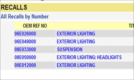

Hello - I haven't heard back from you. Maybe your car is fixed now. I am not sure of your exact model but for the RT model you may have some recalls.. The dealer may fix this for free. Please contact the dealer service department, give them the VIN number of your car and have them check on this to see if it applies to you.
https://images.2carpros.com/forum/automotive_pictures/248015_Recall_16.jpg
