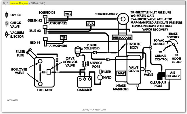

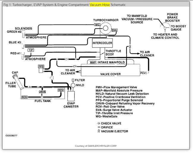

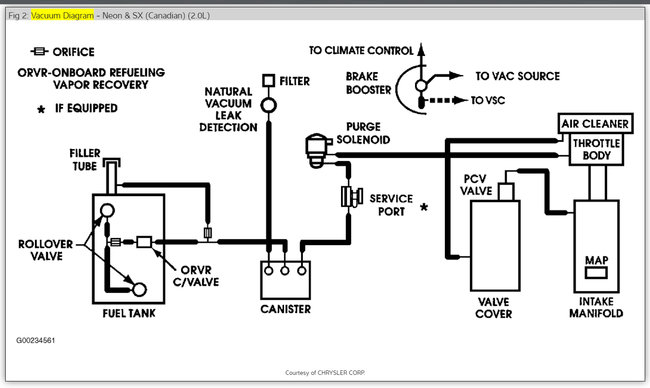

Where can I find a vacuum hose diagram for my 2003 dodge neon?
Sep 30, 2009 at 11:37 AM
  • 55,399 POSTS
Here are three engine and EVAP vacuum hose routing diagrams (Below) Here is a guide to help you check for leaks if you need to when completed.

https://www.2carpros.com/forum/automotive_pictures/99387_Graphic1_527.jpg
In the vacuum diagram in the above link, there is a vacuum hose that runs from the brake booster to the "VSC". Can you please tell me what the "VSC" is, and where it is located. This hose is dangleing in the engine compartment and the car is running rough at Idle, and has a cyl. #2 misfire code. One of the possible causes listed is a vacuum leak. The car has new plugs and wires, and the same code returns after being cleared. (Possible bad coil pack or fuel injector, or timing belt?) Thanks in advance, DON.
Dec 1, 2017 at 4:45 AM (Merged)
BLUELIGHTNIN6
  • 16,542 POSTS
That hose goes to the vehicle cruise control.
