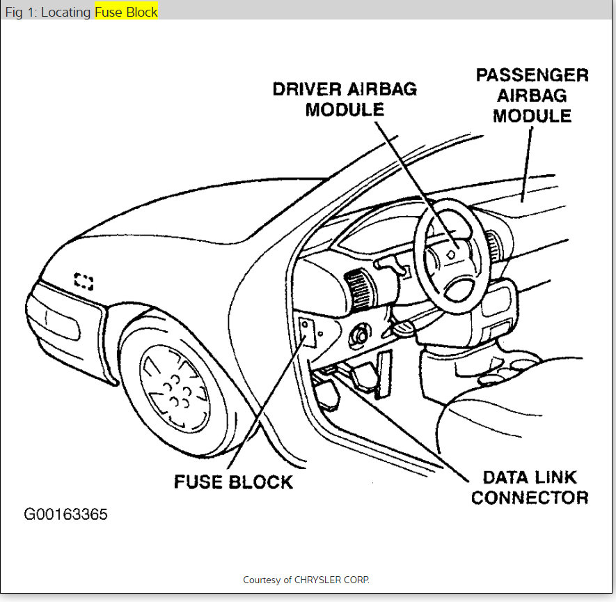

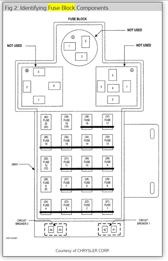

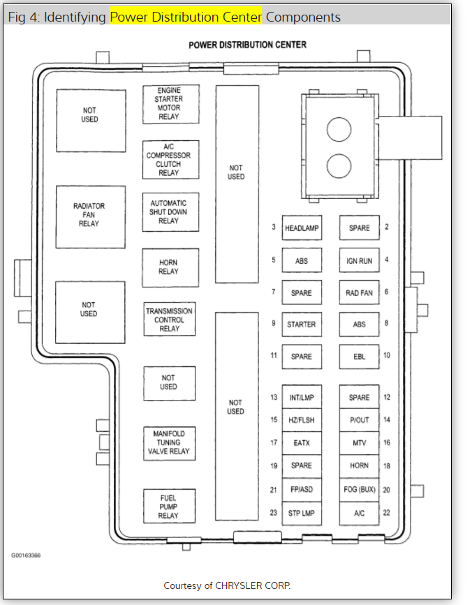

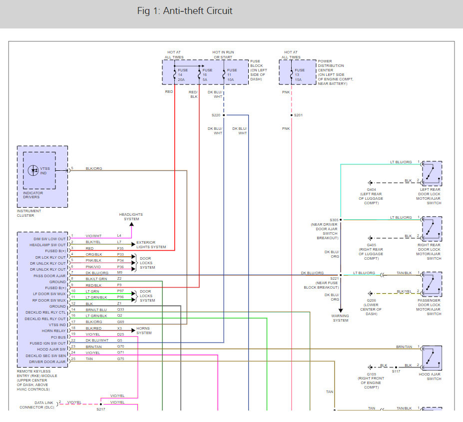

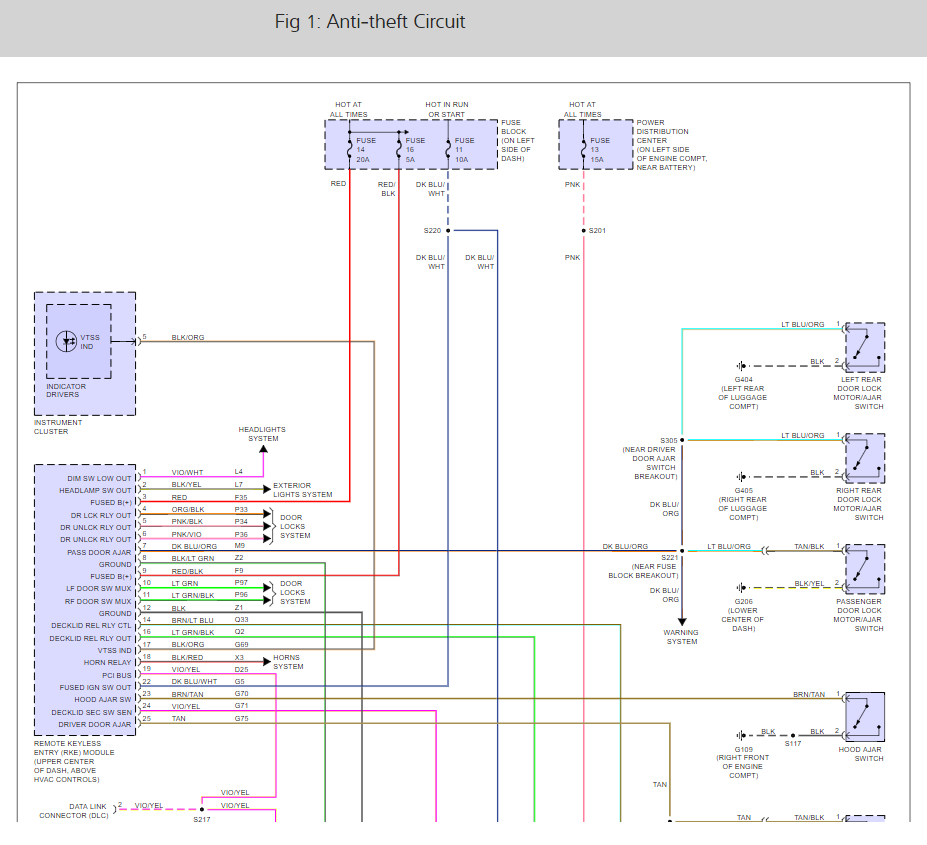

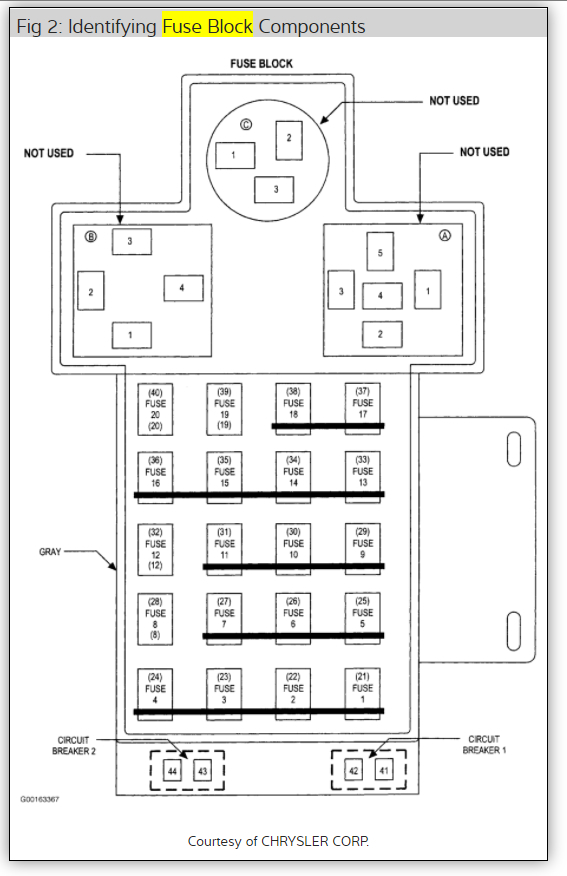

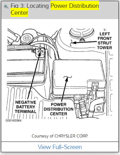

The car does have a security system here is the wiring diagrams for it. I would check fuses #14, 11, 16 and 13.
Check out the fuse panel diagrams (Below)
Thursday, April 15th, 2021 AT 6:56 PM (Merged)
KRHODES11
  • 10 POSTS
This particular model does not have a security system.
It was an option in 2001. Has a black key with no chip.
All fuses check out ok in both the under hood power distribution center and the interior fuse box.

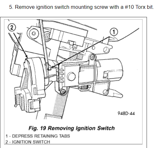

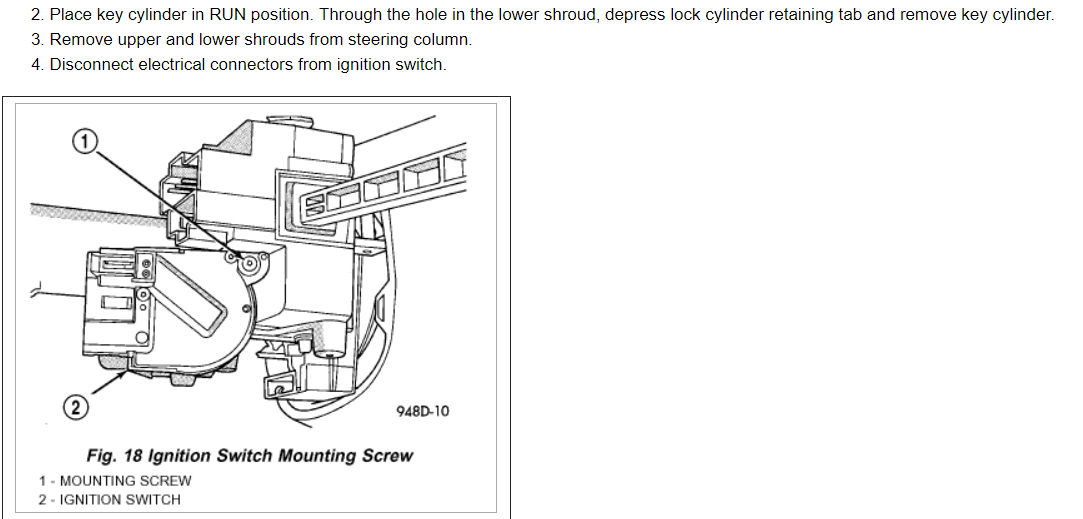

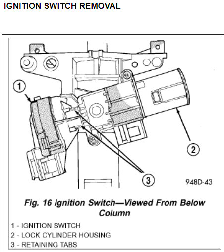

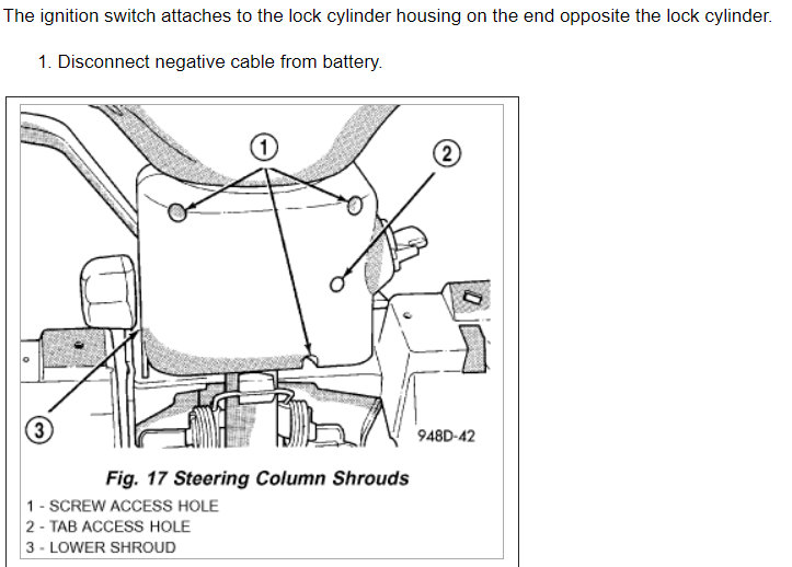

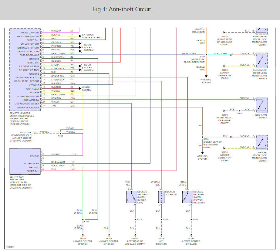

If you checked the wiring diagrams above then the only thing left is the ignition switch lets test it here is the wiring diagrams. Use the guide from about to see if you power in and out of the switch.
Please let us know what you find. (Below)
KRHODES11
  • 10 POSTS
Thanks, Ken. Appreciate all your help. I replaced the ignition switch and it has good power in and out, and power to pin 86 of the start relay when in the start position. The vehicle had an aftermarket front door remote lock system installed. Beginning to think that might be the problem. I can't find the brand name and the owner doesn't have the paper work so haven't been able to find schematics to troubleshoot. The relay bank is connected to the yellow ignition switch wire, and that circuit appears to be working up to the start relay so don't think disconnecting will yield any positive results? Is it possible it could be preventing the PCM from initiating the ground to engage the start relay coil? This one has been quite the challenge.
