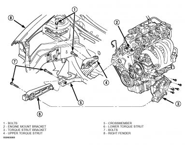

I know that i have three motor mounts on my car but i can not locate the 3rd one to change it. i changed the top and bottom but can't find the star looking motor mount. can you tell me where it's located so i can get it changed?
Aug 23, 2010 at 7:15 AM
DOCFIXIT
  • 18,828 POSTS
Here they are
https://images.2carpros.com/forum/automotive_pictures/198357_Graphic_580.jpg
https://images.2carpros.com/forum/automotive_pictures/198357_Grafic_3_142.jpg
Aug 23, 2010 at 7:36 AM
LINDSEY.CARLSON

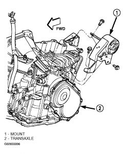

I still can't tell where the 3rd one is located. I have 4 and 6 in place but can't find the rear one.
Aug 24, 2010 at 1:15 AM
DOCFIXIT
  • 18,828 POSTS
Top of transaxle buried under stuff
