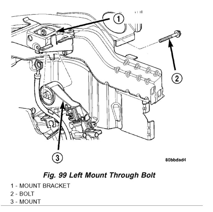

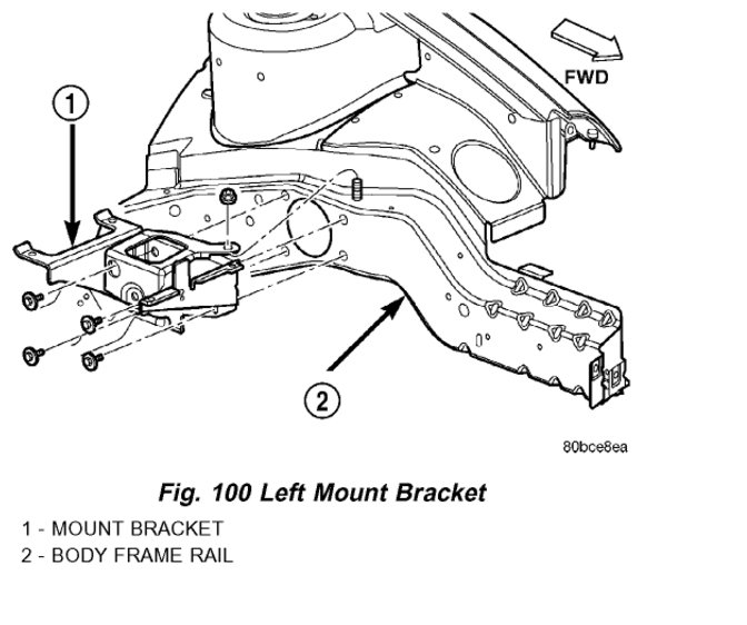

The 2002 Neon has a front (right side) motor mount connecting the timing case cover to the passenger front wheel well frame. It has a transmission mount connecting the transmission to the driver's front wheel well frame. There are also 2 aluminum stabilizer bars on the passenger side (upper & lower) to keep the engine from rotating.
The car vibrates badly most of the time. Both stabilizer bars have been replaced. The transmission mount has been checked and appears OK.
Question: Is the right side mount a solid mount or rubber mounted? This is the only thing I can see that might be causing the vibration, but I can't seem to find an answer or a part to replace it. An experienced answer would surely be appreciated.
Thanks
Fred
Dec 27, 2007 at 11:11 AM
  • 55,694 POSTS
Hey FRERICKSON,

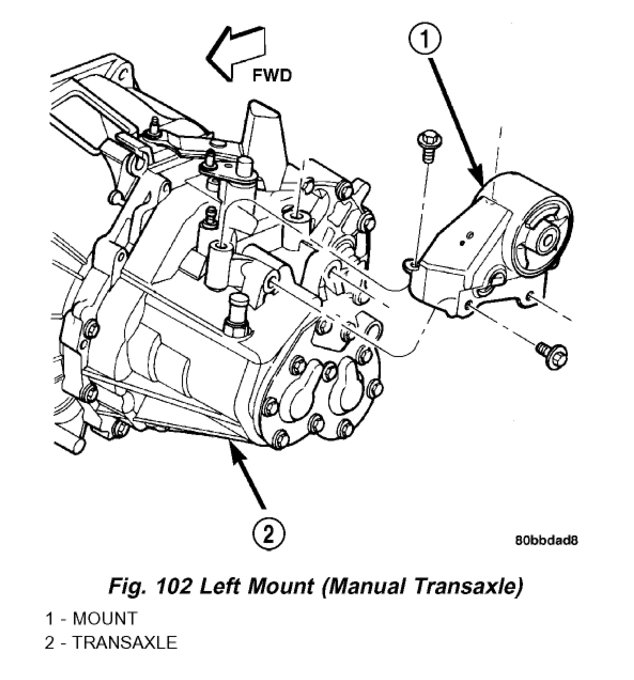

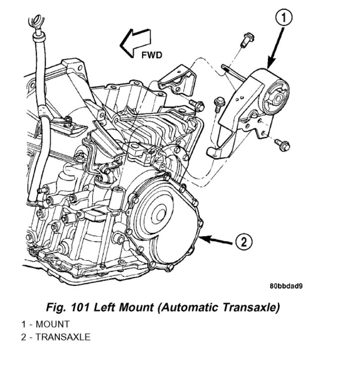

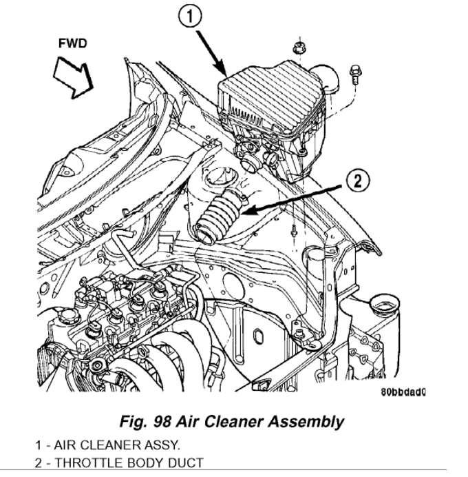

Yes this mount is rubber, here is how you replace it.
Raise vehicle approximately 30.5 cm (12 inch) on hoist
Remove air cleaner assembly (Fig. 98).

Remove through bolt access plug at left side outer frame rail.
Remove mount through bolt (Fig. 99).
Disconnect transaxle shift cable from left mount and transaxle linkage.
Remove left mount bracket to body frame rail fasteners (Fig. 100).
Remove mount attaching bolts (Fig. 101) or (Fig. 102).
Remove mount.

Install mount and attaching bolts (Fig. 101)or (Fig. 102). Tighten bolts to 68 Nm (50 ft. lbs.).
Install engine mount bracket to body frame rail and tighten fasteners to 28 Nm (250 in. lbs.) (Fig. 100).
Position engine/transaxle for installation of through bolt. Install and tighten through bolt to 118 Nm (87 ft. lbs.) (Fig. 99).

Install air cleaner assembly (Fig. 98).
