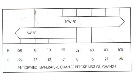

Let me start with your first question. If your vehicle will be driven in temperature between 0 degrees fahrenheit and 32 degrees fahrenheit, than the chart recomends the use of either 5w30 or 10w30. If your vehicle will be driven only in temperature colder than 0 degree Fahrenheit , only 5w30 oil should be used. I provide you the chart here:
https://images.2carpros.com/forum/automotive_pictures/46384_oil_1.jpg
you said this:If this is low pressure though, what am I looking at as far as causes? What are the most likely culprits? What is the long-term damage that can result? well,if this is the situation,you may have faulty warning light or oil pump faulty, oil pump pressure relieve valve stuck open, block oil passages,block oil pick up tube screen, loose oil pick up tube, air leak in oil pick up tube. oil pressure is important for the lubrication systems. long term damage to your engine. let us know after the oil pressure test.
