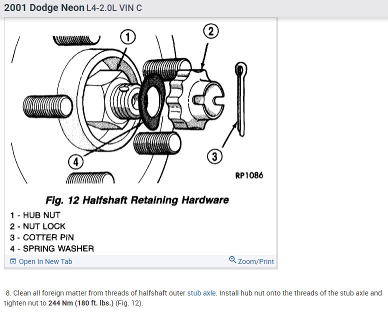

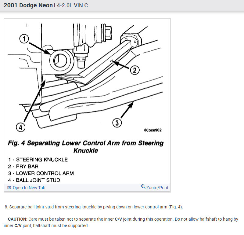

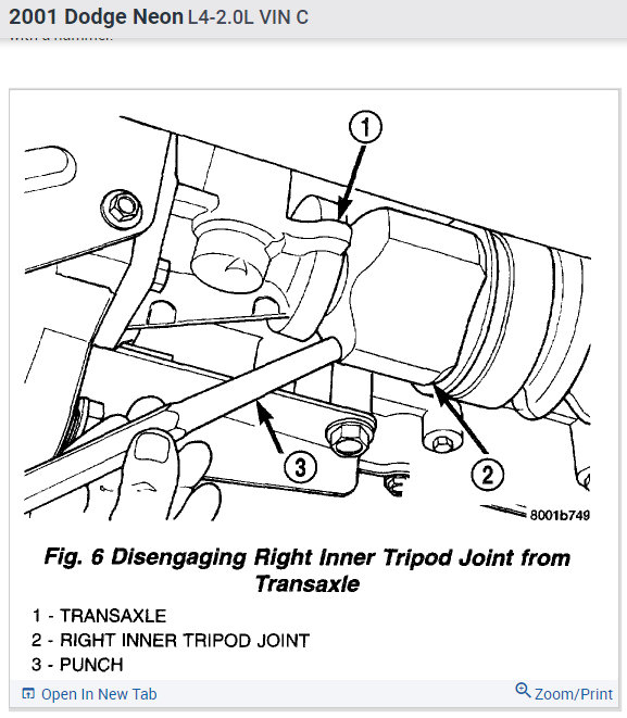

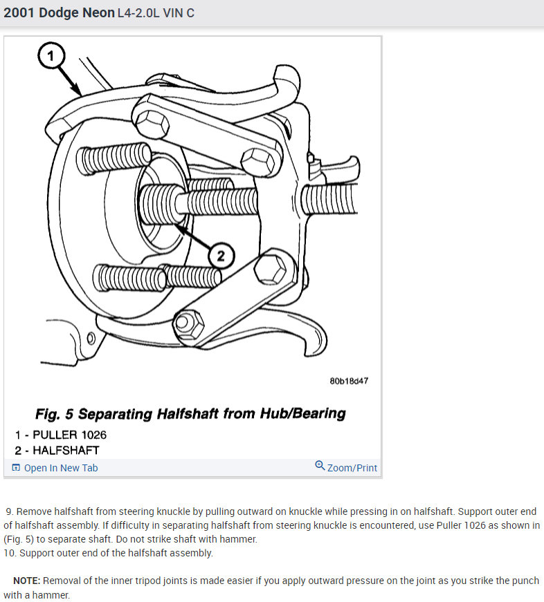

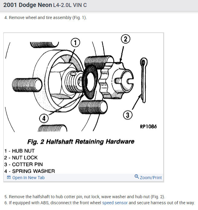

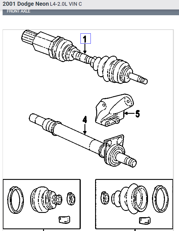

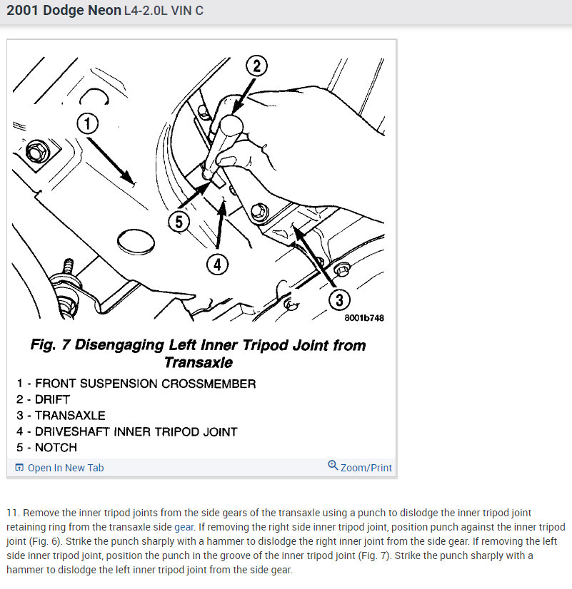

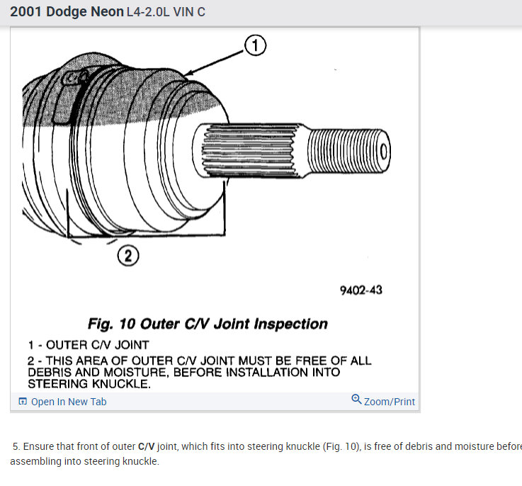

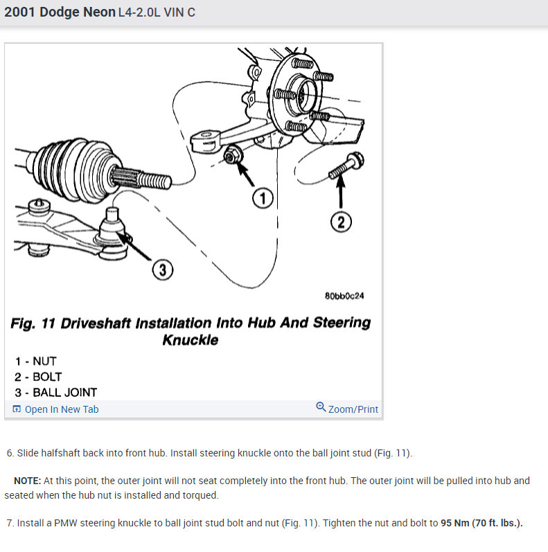

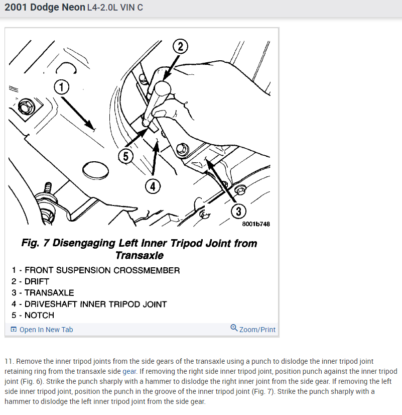

car go hit, need to replace front CV axle. instructions please?
Dec 13, 2009 at 6:25 PM
SQM
  • 6,383 POSTS

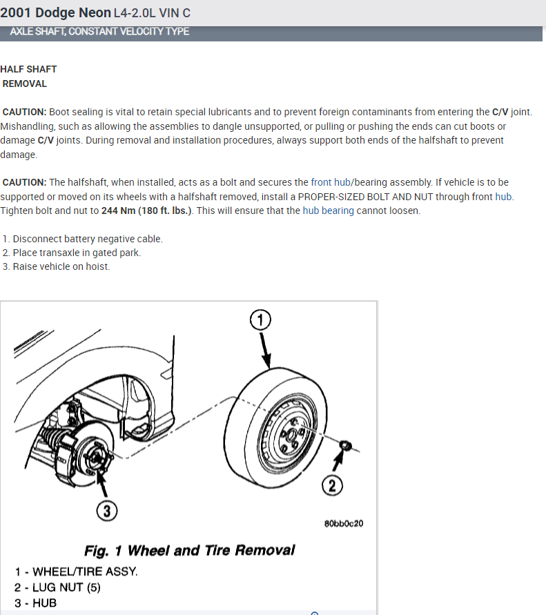

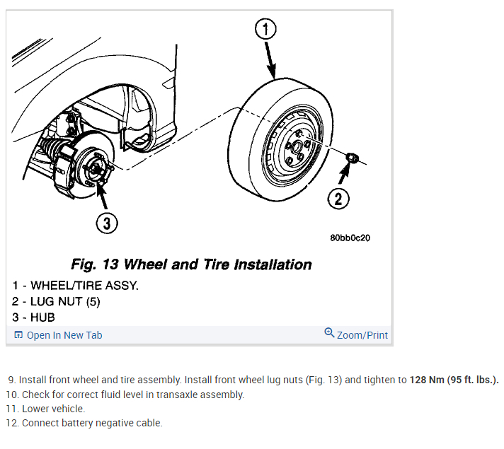

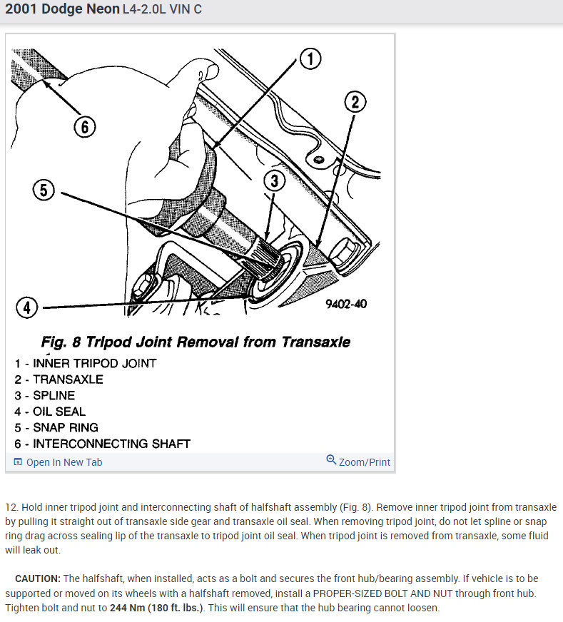

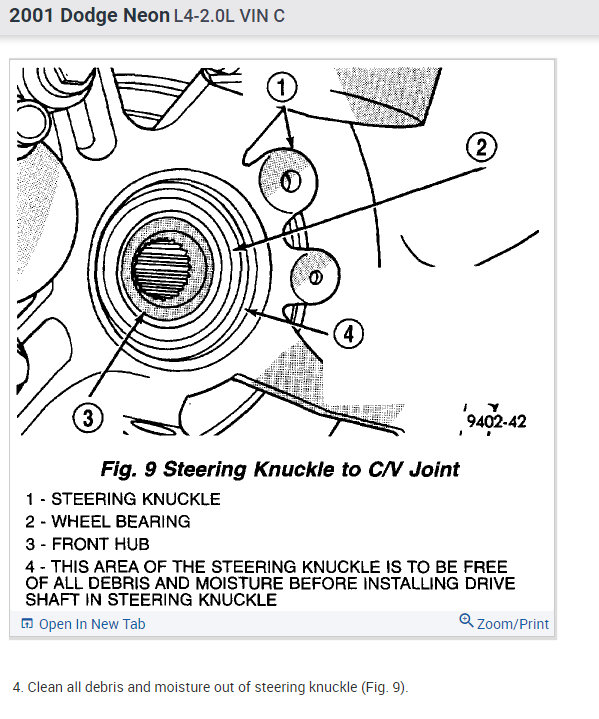

In order to replace the CV axle you will have to lift the vehicle and support it on jack stands.
Take off the wheel, axle nut and get the rotor out of the way.

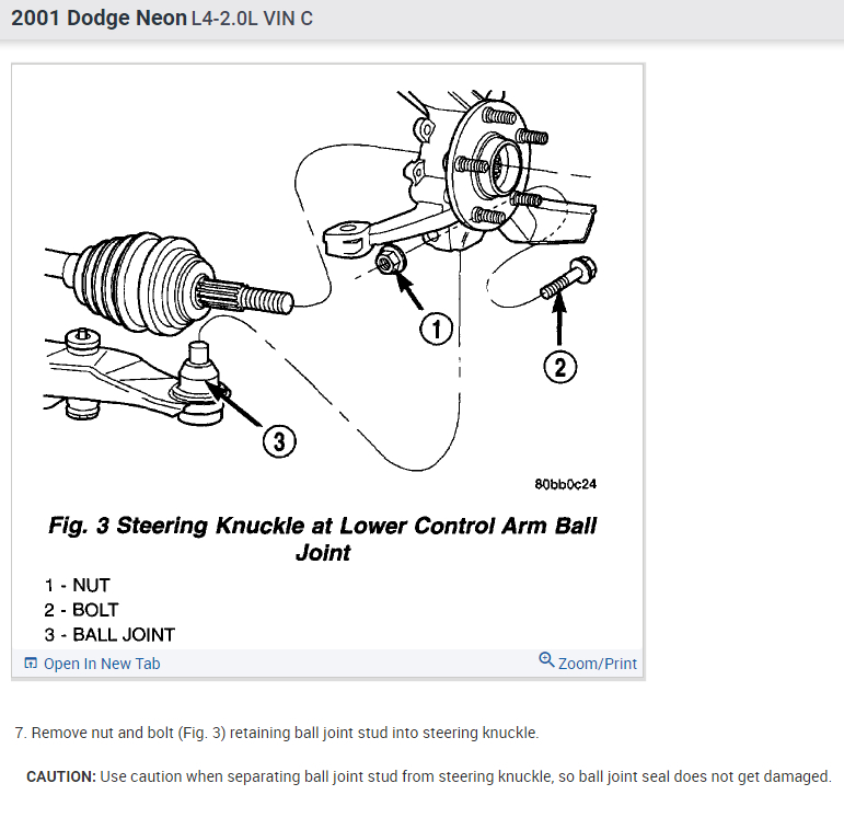

You will also have to loosen the spindle from the control arm.
Then you will have access to the CV axle.
Here is a helpful article:
https://www.2carpros.com/articles/replace-cv-axle
