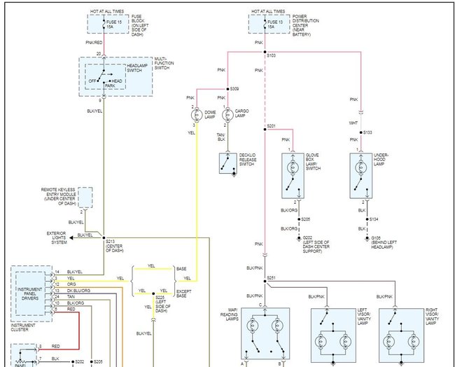

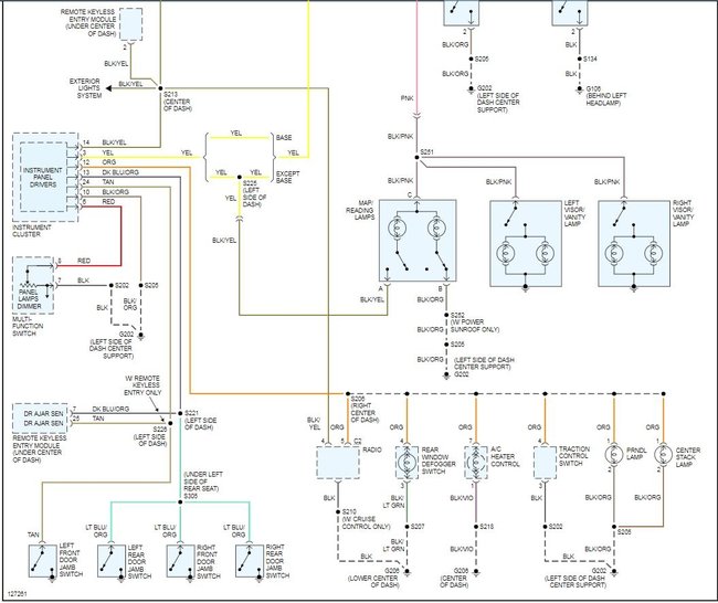

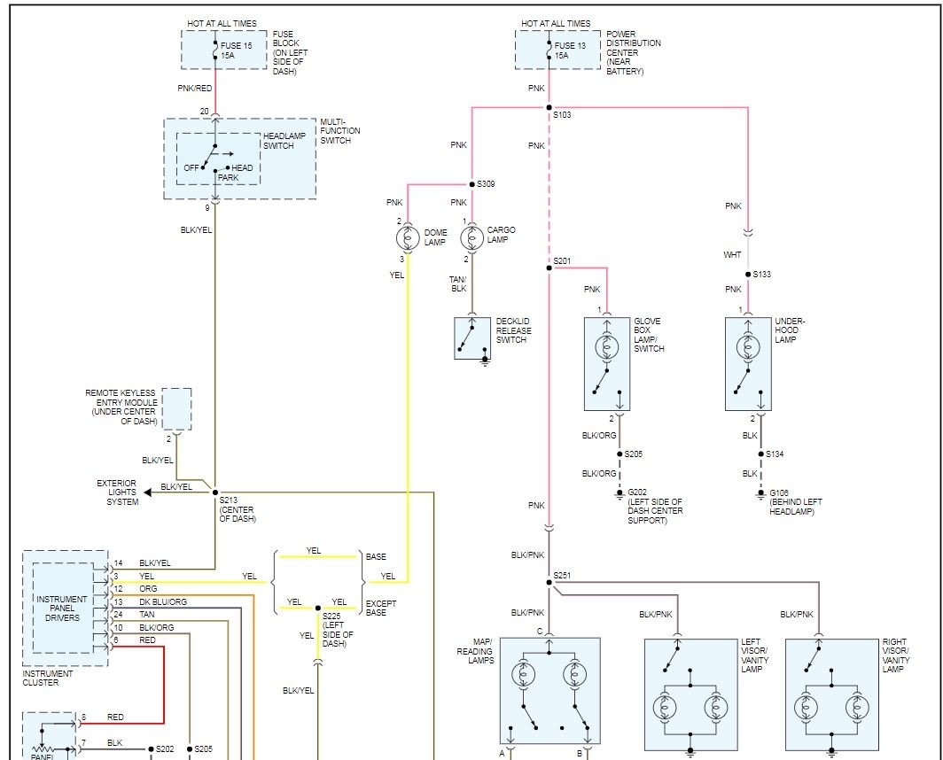

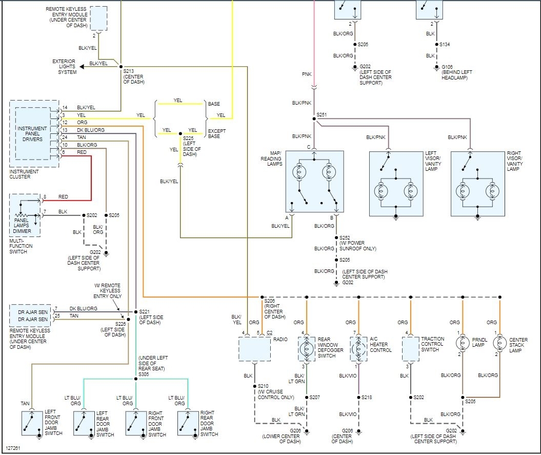

On my daughters car the door light stays on and we have checked all the doors and they are closed but the interior lights won't go off which causes the battery to run down. What would cause this and what do we need to do?
Jun 2, 2009 at 8:40 AM
CARADIODOC
  • 34,308 POSTS
Open each door, one at a time, and push in the door switch to see if one of them makes the light go off. If it does, there's a simple fix. You do NOT have to replace the switch; in fact, you can have the same problem with a new switch.
If that doesn't work, double-check that the dome light switch isn't turned on at the head light switch.
Then, if nothing else works, suspect a defective body controller. This is the price we pay for buying cars with a bunch of unnecessary, unreliable, complicated, expensive computers that do what simple switches did for decades.
caradiodoc
Attached below is the wiring diagram for the interior lights
