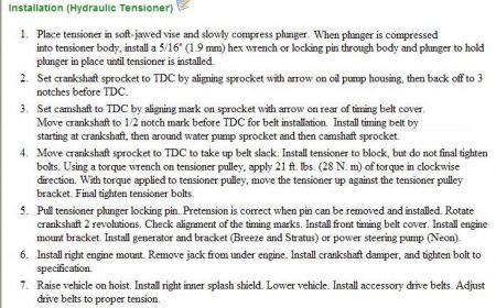

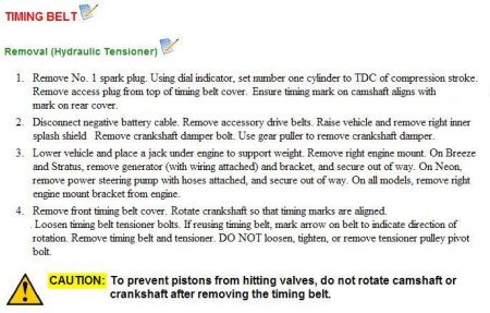

how do I take off the timing cover? Do I have to remove the motor mount
