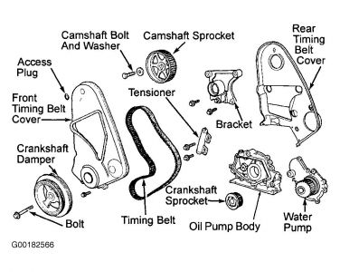

Hi, i have a friend with a 1995 dodge neon. but honestly i dont know how many mile are on it.
But heres my question
What do you need to know about replacing the timing belt, are there any bolts you need to watch for, and whats the safest way to do it?
Thanks
Caper
Apr 17, 2008 at 7:27 AM
BMRFIXIT
  • 19,053 POSTS
What u need to watch for is setting the timing belt need to have a special tools you need a pulley puller to remove crank shaft damper
