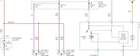

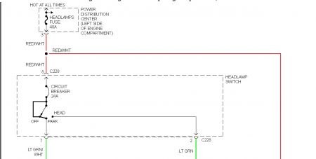

Electrical problem
1995 Dodge Neon 4 cyl Front Wheel Drive Automatic
Headlights or brights will turn on. None of the fuses where burnt out. I did notice the person who own the car before me put wrong fuses in under the dash for one of the H.L.,Radio and Lighter. I used a tester for the headlight switch and the fuse box both under the hood and got power. I didn't notice any damage to the wires that connect to the H.L. switch.
Aug 21, 2010 at 10:40 AM
JDL
  • 16,098 POSTS
Did you check for voltage and ground at the headlamp connector? All the fuses in the diagram have voltage? The info I looked at was w/o drl. Somehow I left out the diagram for the dimmer switch?
