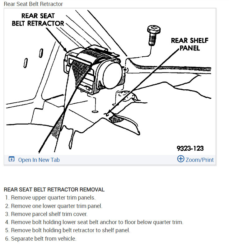

Have a 96 ES 3.5L, and the rear selt belt will not retract, can't figure out how to even get to it. Do i need to replace or can i repair? And how do i get to the bugger?

Me again, still can't figure out how to get to the belt

You must replace it if it stops retracting, they make them tamper proof for safety reasons. If the part is obsolete, try Ebay or a wrecking yard of a used one. Here is how in the images below.
