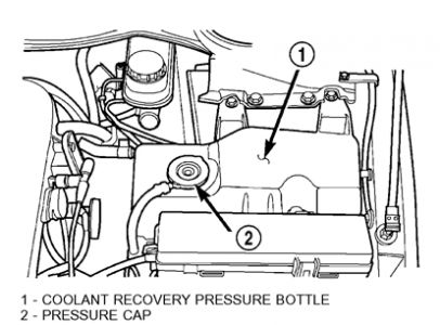

The temp gauge stays at its normal level. Im not sure exactly where the radiator fluid is on my 03 2.7 liter
Jun 2, 2010 at 1:54 PM
BLUELIGHTNIN6
  • 16,542 POSTS
https://images.2carpros.com/forum/automotive_pictures/261618_Noname_2305.jpg

yep i check all of it its fine. The guys at the shop said its some electrical problem and they replaced my relay ans it burned out again
