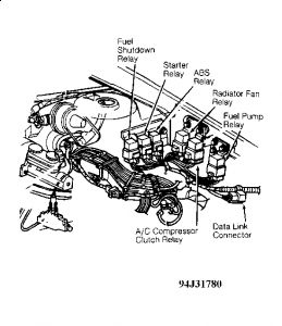

Hello - Great job and thanks for the info.........the code is kind of what I have...... CODE 35 DRB displays RADIATOR FAN RELAY CTRL CIRCUIT. Condition is: open or shorted condition detected in radiator fan relay circuit. If you don't mind to be safe how about putting it all back together and clear the codes and then try it again..........that way we are not chasing rabbits......... Then we will pull some more tests. I have attached them below. OPERATION OPERATION Radiator fan operates when coolant temperature sensor verifies coolant temperature has reached predetermined temperature (depending on model). On reaching specified temperature, coolant temperature sensor contacts close, allowing current flow to radiator fan relay and fan motor. Fan shuts off when coolant temperature drops to predetermined value (depending on model). Radiator fan should always operate when A/C compressor clutch is engaged. On models with dual electric fans, fans operate through a common relay and are activated at the same time. SYSTEM TESTING 1. Check fan motor operation. See MOTOR under COMPONENT TESTING. If motor is okay, turn ignition on and check for voltage at fan relay Gray (or Light Green/Black) wire. Radiator fan relay may be located in power distribution center (left front inner fender panel) or in front of left strut tower. See Fig. 1 . If battery voltage exists, proceed to next step. If battery voltage does not exist, check for open or short in Gray (or Light Green/Black) wire circuit.
https://images.2carpros.com/forum/automotive_pictures/248015_f1_3.jpg

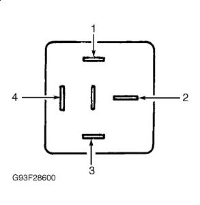

3. If battery voltage is not present, repair short or open in Red/Light Green wire circuit. If battery voltage is present, remove low speed or high speed fan motor relay. Using an ohmmeter, ensure continuity exists between terminals No. 1 and 3. See Fig. 3 . If continuity does not exist, replace relay.
https://images.2carpros.com/forum/automotive_pictures/248015_f3_4.jpg

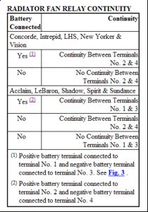

4. Connect ohmmeter to relay terminals No. 2 and 4. Check continuity with and without battery connected. See RADIATOR FAN RELAY CONTINUITY table. Replace relay if continuity is not as specified.
https://images.2carpros.com/forum/automotive_pictures/248015_Relay_2.jpg

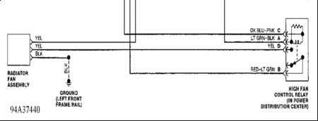

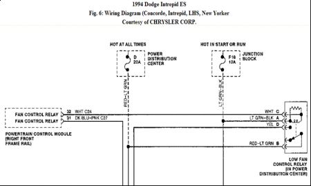

Is there a way to test from the connector that goes into the module mounted on the fan assemble and go directly to the fan motors? In other words by pass the module? I am thinking that would tell if the module is bad or if there is a short n the wires going to the module.
Aug 19, 2009 at 2:03 AM
IMPALASS
  • 3,112 POSTS

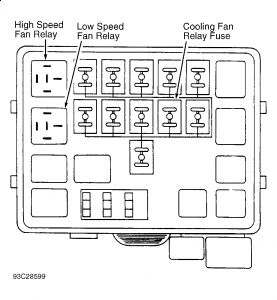

Hello - I have attached a wiring diagram of the system...... I put it in a couple of pics to make it big enough.
https://images.2carpros.com/forum/automotive_pictures/248015_6_22.jpg
https://images.2carpros.com/forum/automotive_pictures/248015_6b_1.jpg
Pleases verify fuse D in the power distribution center and F18 in the junction block are good with an ohm meter Also you have checked the fan control relay coming out of the module?

Fuse 18 is fuel pump, f20 is fan, both looked good.
Not sure which fuse is D in the power distribution block but all the fuses looked good.
Not sure what you mean by fan control relay coming out of module. Are you talking about the module on the fan assembly? I assume the relay is part of the module and not a separate piece.
If I hook up a meter to the module output should I be getting a voltage reading? Will I have to wait for the car to get hot or should I be getting a reading with the AC on?

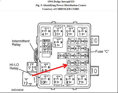

Hello - So sorry for the delay........had major technical problems........so limping along here but will do what we can. Okay............on the fuses.......they may look good but please do me a favor....check with an ohm meter or a know good fuse......I have had them that look good but are not......... Next, did you check the relays out according to the tests above - how were they? I think you did by your response....just making sure I am on the right page as you. I attached the power distribution showing D
https://images.2carpros.com/forum/automotive_pictures/248015_Power_distro_1.jpg
Doesn't matter if the car is warmed up or not if you turn the AC on.......the fans should come on so go ahead and check for readings.

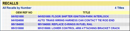

Hello - That will be fantastic.......I will be looking forward to hearing from you if you don't mind plus that will help others. Also, it looks like you may have some recalls on your vehicle. The dealer may fix these for free. Please contact the dealer service department, give them the VIN number of your car and have them check on these to see if they apply to you.
https://images.2carpros.com/forum/automotive_pictures/248015_Intrepid_Recalls_1.jpg
