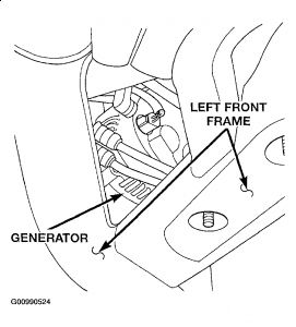

REMOVAL - 2.7L
1.Disconnect negative battery cable.
2.Raise and support vehicle.
3.Remove lower plastic splash shield (Fig. 22 ).
https://www.2carpros.com/forum/automotive_pictures/55316_02intrepidalt27_1.jpg
4.Remove transmission cooler and reposition cooler out of the way.
5.Remove lower radiator crossmember support and position a jackstand under radiator for support.
6.Loosen adjusting T-bolt, but do not remove.
7.Loosen pivot bolt, but do not remove.
8.Remove the generator drive belt.
9.Disconnect the generator field circuit plug.
10.Remove the B+ terminal nut and wire.
11.Remove pivot bolt, being careful not to lose spacer.
12.Remove generator.
