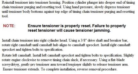

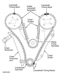

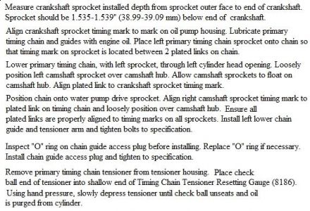

how to time a 2.7v6 in 2001 dodge intrepid
