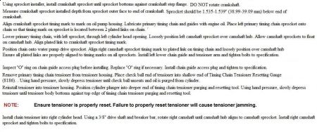

2001 Dodge Intrepid how to set the timing on A2.7v6
R WYLIE
MEMBER
2001 DODGE INTREPID
Engine Performance problem
2001 Dodge Intrepid 6 cyl Front Wheel Drive Automatic
Wednesday, March 10th, 2010 AT 3:41 PM
BLUELIGHTNIN6
MECHANIC
16,542 POSTS
SPONSORED LINKS
Wednesday, March 10th, 2010 AT 4:14 PM
