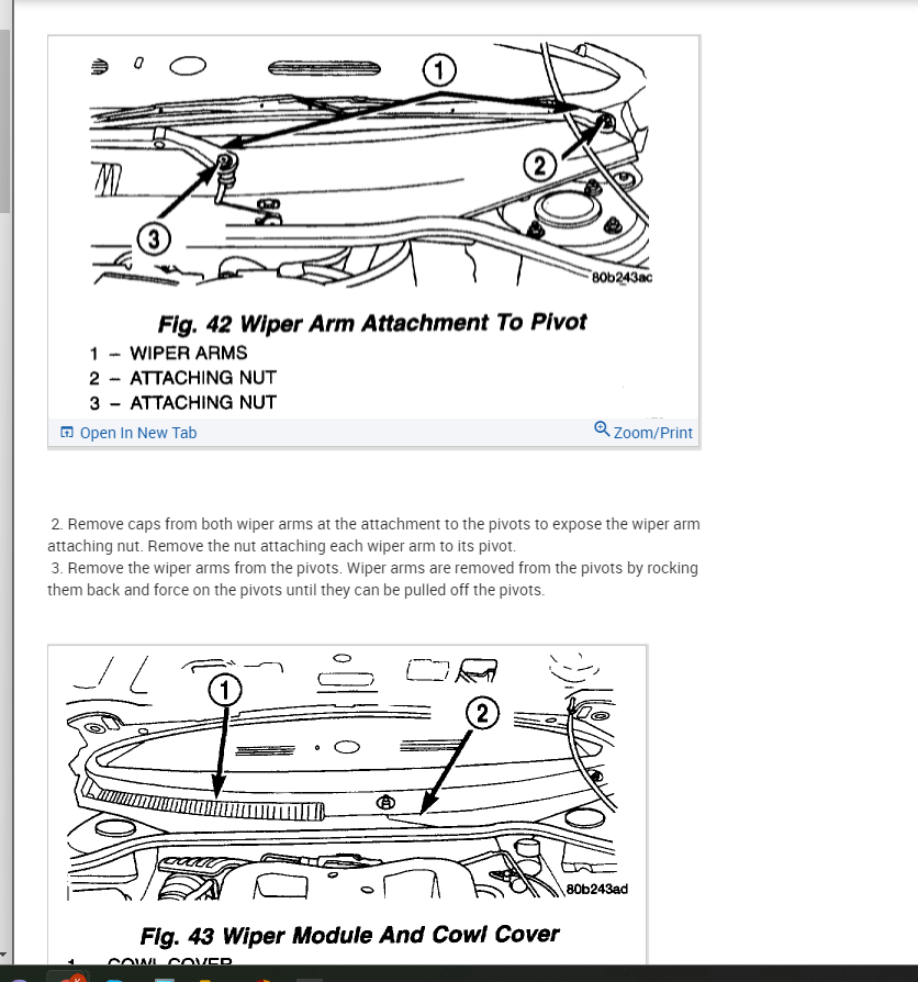

going down the road, slow down to turn and mash the brakes the car will cut off, not all the time. what can i do to fix this , thank you

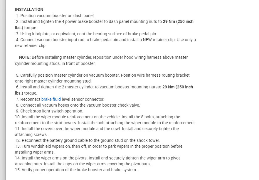

More than likely you have a vacuum leak either in the intake or the brake booster that we need to find.
Here is a guide that will help with this:

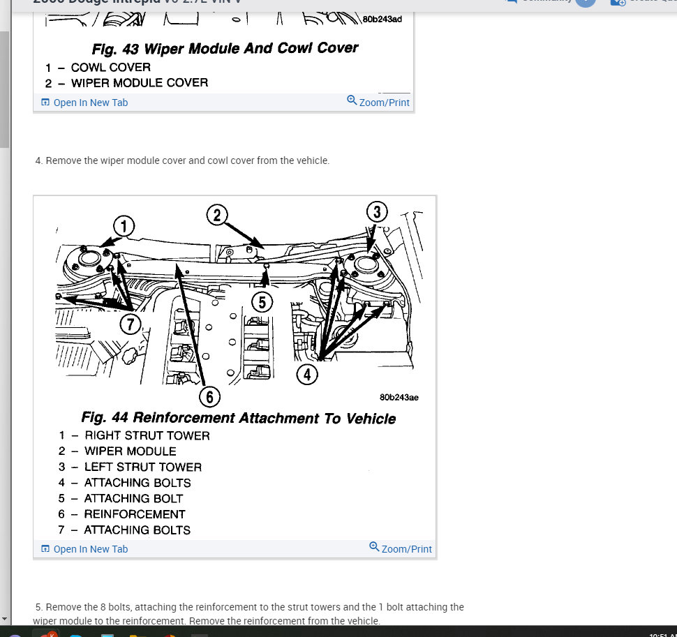

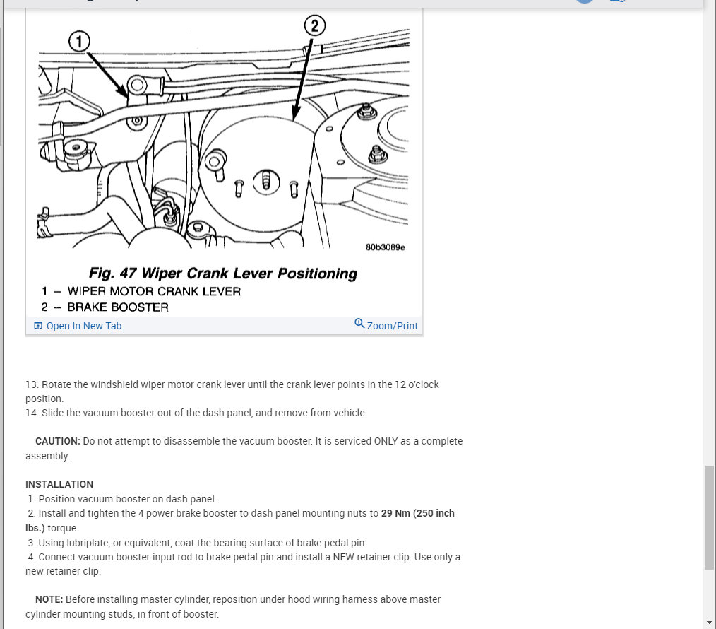

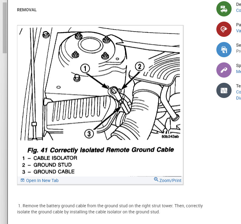

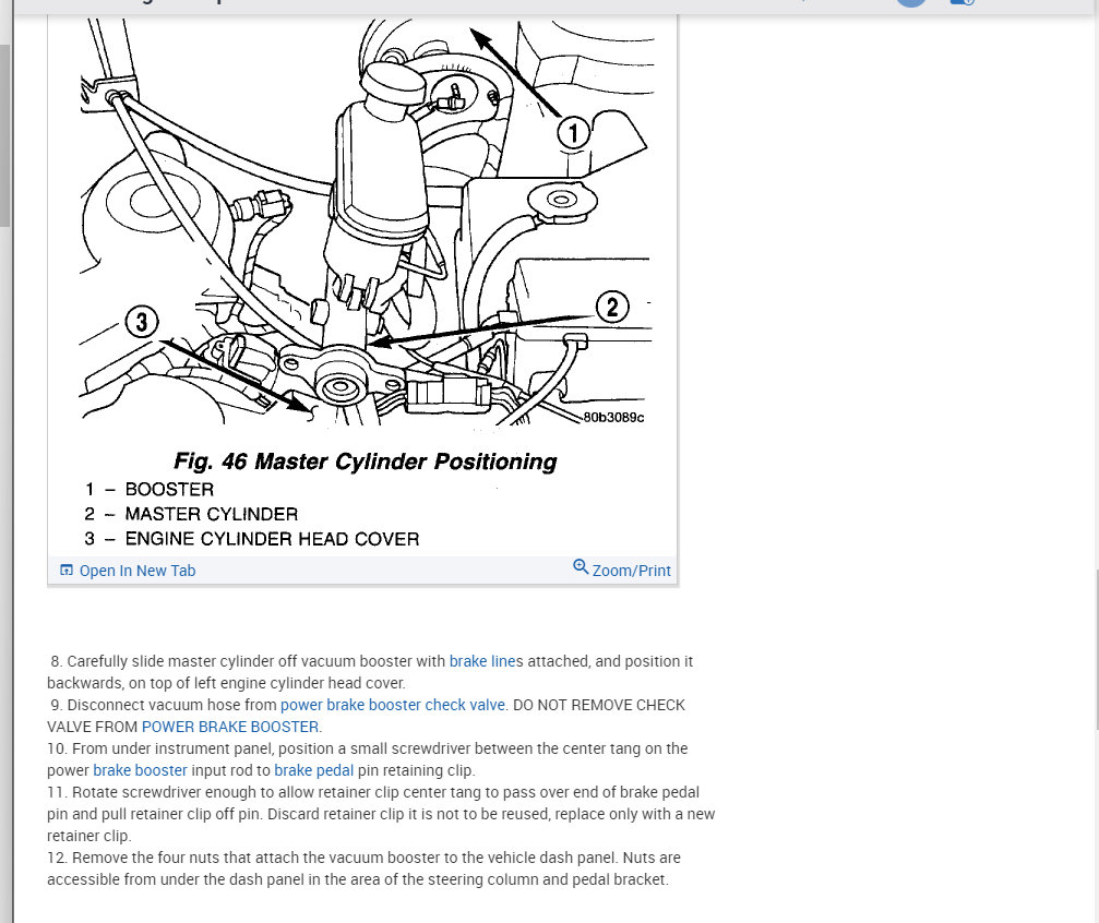

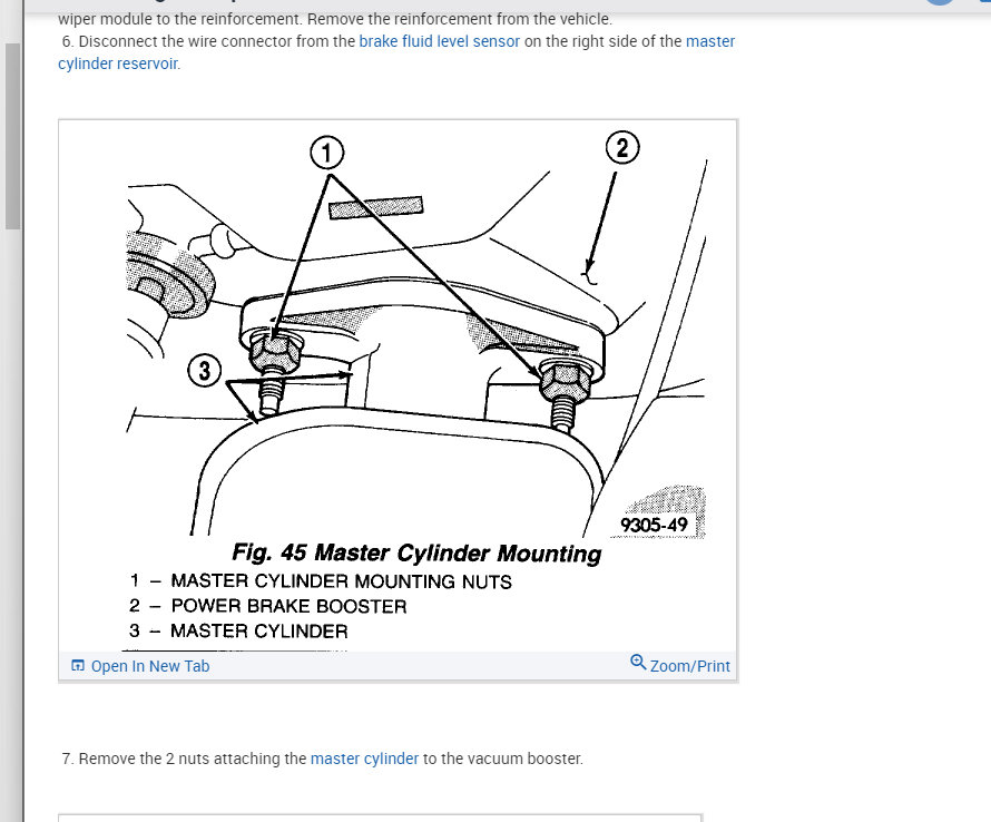

If you find no vacuum leak, then I would replace the brake booster because what is happening when you press the brakes hard is basically causing the engine vacuum to drop too low and this will stall the engine.
I am attaching the info below that will help with doing this.
Please run through this information and let me know what questions you have.
Thanks
