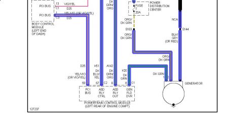

My battery light in my dash board. Sometimes it doesn't come on until its been running for at least 15 minutes, then it comes on. I took it to the Autozone and have it battery check as well as the alternator. They said that the result was good and that the battery is good and the alternator as well. I don't know exactly what it is that cause to light my battery light on.
Could that be possibly the sensor light of the battery is out? Please, help.
Thanks,
sebastian
Jan 31, 2010 at 11:45 AM
  • 75,988 POSTS

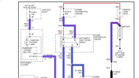

Hi sebastian_personal, Welcome to 2carpros and TY for the donation. Check these fuses: fuse no.1 10amp in junction block, fuseN 30amp and fuseT 20amp in the power distribution box if all okay-have the PCM field generation driver circuit tested. To include the ASD relay See Charging system EWD below
