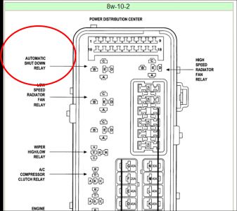

I have 2000 Intrepid, it crnaks over, I pulled 2 plugs to check for spark and there is nothing, each plug has it's own coil. also the gap seems a bit large, more then .050 any thoughts?

Hello –
I can give you a couple of things, but if you need to get back with us please let me know if your vehicle is an Intrepid or Intrepid R/T. Also, is your engine a 2.7L, 32.L or a 3.5L and I will need to know the 8th digit of your VIN.
Next, you pulled two and no spark at those…..can you check the others since each has it’s own coil therefore should have a spark to the rest if one is bad, or the others if 2 are bad.

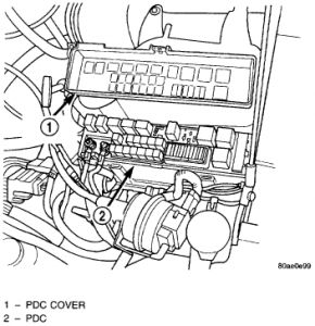

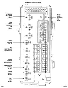

Next, the Automatic Shut Down relay, (ASD) controls the spark to those coils, it gets a signal from the crankshaft sensor and camshaft sensor then all that of course goes to the PCM to shake around and come up with info for the car to run.
I have attached the location of the ASD, it may be bad, if all are not getting a spark, I would replace the ASD.
Anymore info than this and I would prefer to have the correct model and engine.
