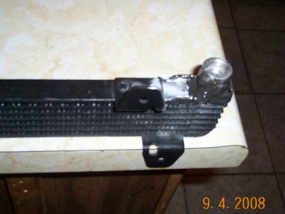

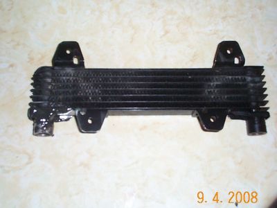

On my 1999 Dodge Intrepid 6 Cylinder 2.7L, I had taken out the Radiator to hose it off for bugs. During the process, I busted one of the outlets that one of the trany lines screw up to. I used "J.B. Weld" to put it back on there. Now if by chance this doesn't work, can I Bypass the little oil cooler radiator and just hook up the two lines together? Please let me know. Thank you very much.

Hi there,
You can by-pass the cooler for a short time, but i would not want to have it in-op for an extended period, i would be replacing it sooner rather than later.
Mark (mhpautos)
