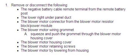

I've been having the same problem with my 1999 Intrepid. I've now replaced the resistor 3 times. I read somewhere that it could be that the fan motor is pulling too many amps, which causes the resistor to fail. What do you think? Do you have any documentation/drawings for how to replace the fan motor? Any other suggestions you may have are welcome also. Thanks!
Tuesday, December 22nd, 2009 AT 6:11 PM
JDL
  • 16,098 POSTS
Hi, the info below is 2.7 engine blower removal. Disarm the airbag, where applicable, when working around the dash. Take the negative battery cable loose and isolate it. Wait a few minutes before proceeding.
http://www.2carpros.com/forum/automotive_pictures/170934_blower_motor_removal_1.jpg
