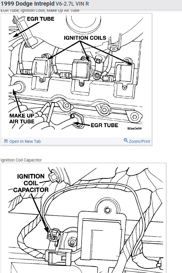

i recently had the sparks plugs and a damaged fuel injector changed, the computer display showed an error of a misfire on cylinder 1. since the repair the light comes on and stays on...when i start the car after being cold it shacks and has a faint knocking sound...then at times it stalls, but then starts right up ...what could this be??????????

It sounds like you might have a cylinder misfire and possibly injector flooding the cylinder, that's why you hear that faint knocking sound.
https://www.2carpros.com/articles/how-a-knock-sensor-works
If your check engine light on then you should run a scan to see what are the codes.
https://youtu.be/vMwTzURWXmk
You might still have a cylinder not firing properly.
Check the coils and see if they are working properly.
You can check to see it its getting power. If you got a bad coil then it will not provide power to the spark plug.
