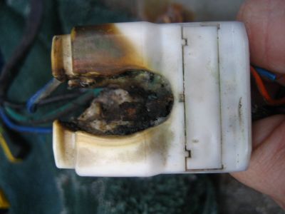

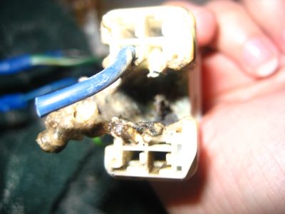

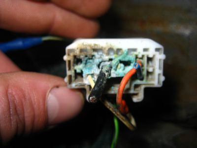

I am thinking this might have been the problem and i am definately wondering how if the shop charged me 500.00 and said they went thru my electrical system they missed something like this.

So what would be the best course of action for getting my money back from the dealership seeing as how they didn't do the work they said they did.

I'm sure Impala SS is going to want to see this one.
As far as your money, I would go back with a handful of burned parts snd an attitude. Let us know how it comes out. Sad, but true fact, we hear about this kinda' stuff all the time.

All I can say is wow..... That is amazing..... Okay...I gotta say... When you said "... Wires are bare and shorted enough to melt half the plug..." I am thinking something different than this.
Pics speak a thousand words.
Mr Weizel is correct there....... Sad but we do see that.

On the cooked plug all I had to do was tie the heavy black to the heavy black, dark green w/ white stripe to dark green w/ white stripe, and the dark blue to dark blue. I still need to "water proof" the connections but about 400 miles later running the car hot, cold, hard, gentle, fast, slow and haven't had any more problems from the fuel system. It even seems to run better than it has as long as I have owned it. You guys have been so much more help than I could have ever hoped. I can't thank you enough.

Hey, just note, make sure you look around there to see if something right there caused it. Are the wires rubbing something sharp, can they be pinched etc... You know what I mean? Since it happened, just ask why and look around there really good.

Given the corrosion on the back of the plug and the rust on the ground there near by I am in hopes it was simply a matter of moisture in the area. So I am hoping a wire brush to clean them and some waterproofer should do the job. Haven't called the dealership yet still getting everything going. It is a trip now cause I work 2 weeks up in wyoming then when I come back for my 2 weeks off I am getting another job rolling to help cover bills.
