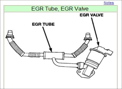

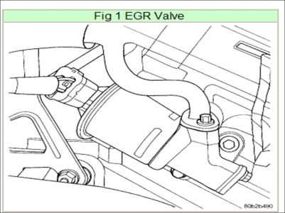

Hello - Since Mr Weizel is already assisting you I have provided info where the EGR valve is to aid him in your response to get your car fixed quicker. You might also let him know if your car is a 2.7L VIN R or a 3.2L VIN J. The VIN is the 8th digit of your VIN number. Also is your model just a Intrepid or Intrepid ES? 1. The EGR valve attaches to the rear of the right cylinder head.

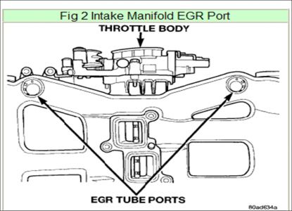

Hello - This one is for the 3.2L

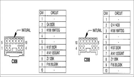

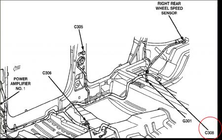

Hello - On the fuel gauge...I did find a TSB that you could check on a bad wire connector under the seat. If that isn't it then it is probably the sender on the fuel pump. If it were me....if I went to the trouble to drop the tank....I would change the entire fuel pump. Last, you may have some recalls on your vehicle. The dealer may fix these for free. Please contact the dealer service department, give them the VIN number of your car and have them check on these to see if they apply to you. Fuel System - MIL ON DTC Set/Driveability Concerns Notes NUMBER: 08-35-99 GROUP: Electrical DATE: Oct. 8, 1999 SUBJECT: MIL Illumination, Leak Detection Pump DTC and/or Fuel Gauge Inaccurate OVERVIEW: This bulletin involves replacing the inline fuel tank to left body harness connector with a sealed connector. MODELS: 1998 - 1999 (LH) Concorde/Intrepid/LHS/3OOM SYMPTOM/CONDITION: MIL illumination with Leak Detection Pump (LDP) Diagnostic Trouble Code (DTC), fuel gauge reading inaccurate, fuel pump not working, and/or engine run-on. DIAGNOSIS: Using the Mopar Diagnostic System (MDS2) and/or the Diagnostic Scan Tool (DRB III) with the appropriate Diagnostic Procedures Manual, verify all engine/transmission systems are functioning as designed. If non-LDP related DTC's are present, record them on the repair order and repair as necessary before proceeding further with this bulletin. If Leak Detection Pump DTC's are present, and/or owner describes an inaccurate fuel gauge or engine run-on, inspect the C308 wire connector located under the rear seat cushion for the presence of moisture and/or corrosion. If moisture/corrosion exist, perform the Repair Procedure. PARTS REQUIRED: 1 05013984AA Insulator/Terminal Repair Kit 1 05013988AA Insulator/Terminal Repair Kit 12 04778570 Heat Shrink Tubing POLICY: Reimbursable within the provisions of the warranty. TIME ALLOWANCE: Labor Operation No: 08-90-73-90 0.8 Hrs. FAILURE CODE: P8 - New Part Repair Procedure Notes 1. Disconnect and isolate the negative battery remote cable. 2. Locate and remove the existing C308 connector by cutting the five wires (LDP equipped)/three wires (non-LDP equipped) on each side of the connector. Stagger cut all wires on the harness sides at 1/2 inch intervals. 3. Remove 1 inch of insulation from each wire on the harness sides. 4. Stagger cut the matching wires on the repair connector assemblies in the opposite order of the harness stagger. 5. Remove 1 inch of insulation from each wire on the repair connector. 6. Place a piece of heat shrink tubing over one side of the wire. 7. Spread the strands of the wire apart on each part of the exposed wires. 8. Push the two ends of wire together until the strands of wire are close to the insulation. 9. Twist the wires together. 10. Solder the connection together using rosin core solder. Do not use acid core solder. 11. Center the heat shrink tubing over the joint and heat using a heat gun. Heat the joint until the tubing is tightly sealed and sealant comes out of both ends of the tubing. 12. Repeat steps 6 through 11 for each wire. NOTE :ALL CAVITIES IN THE SIX-WAY INLINE CONNECTORS, ON BOTH SIDES OF THE CONNECTION MUST BE FILLED WITH TERMINATED WIRES. ANY WIRES THAT ARE NOT USED MUST HAVE THE NON- TERMINATED END SEALED WITH HEAT SHRINK. 13. Re-tape the wire harness and connect the connector halves. 14. Connect the negative battery remote terminal.

when i had the tank dropped i did replace the full assembly (fuel pump, tank sending unit, etc...) where is the C308 connector mentioned in that tsb i seem to have the same and reversed symptoms. (the fuel gauge is random, but instead of running on the vehicle dies on the road) i am thinking a bad connection thru the plug its mentioning removing "may" help if not then i am where i am now and resolve a tsb on my car
Dec 6, 2008 at 1:14 PM
IMPALASS
  • 3,112 POSTS
Hello - Sorry - read right through that.....yes.....you did replace the pump..... That TSB says it is located under the rear seat: inspect the C308 wire connector located under the rear seat cushion for the presence of moisture and/or corrosion I have attached a pic.....

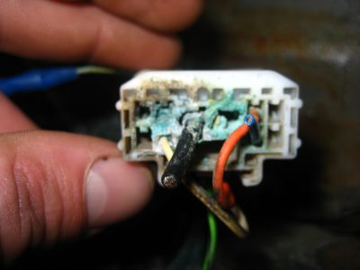

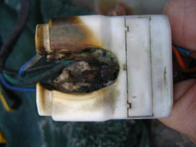

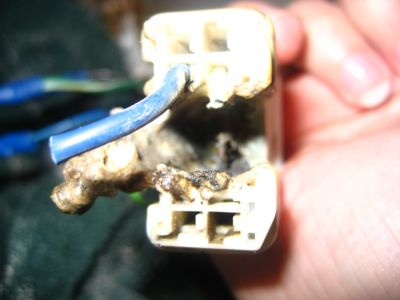

WOW. i think i found the c302 plug it has 3 wires on one side and 5 to 6 in the other side. the side with 3 has corrosion coming out of the ports on the plug and 2 of the wires are bare and shorted enough to melt half the plug, the other side has the same corrosion coming out of the plug and wires corroded all the way through. i am about to do the bypas mentioned in the tsb. but i am pretty sure this will solve the problem. i will keep yall posted with how it runs.

Hello - Yes please do.....I thought the TSB said connector C308......I have attached that info. I am showing 302 by the door /body area........ Interesting - if I remember the TSB it does talk about corrosion etc..... If you do find the wires/plug....be sure to check all over for that corrosion....that could go deep into the wire and be causing problems. Though it said under the seat......what about under the car......where the seat is? I just checked another manual and it says C308 is in the trunk area. I have attached another pic.....it looks to me like the wire colors are Dark Blue, Dark Green, Orange, Dark Green w/White Tracer, Black, and Light Green w/ Black tracer.

I am thinking this might have been the problem and i am definately wondering how if the shop charged me 500.00 and said they went thru my electrical system they missed something like this.

I'm sure Impala SS is going to want to see this one.
As far as your money, I would go back with a handful of burned parts snd an attitude. Let us know how it comes out. Sad, but true fact, we hear about this kinda' stuff all the time.

All I can say is wow……that is amazing……..okay….I gotta say….when you said “…wires are bare and shorted enough to melt half the plug…” I am thinking something different than this.
Pics speak a thousand words.
Mr Weizel is correct there………sad but we do see that.
If it were me, I would take plenty of pics and well, I can only tell you what I have done and you take it from there and do what works for you.

on the cooked plug all i had to do was tie the heavy black to the heavy black, dark green w/ white stripe to dark green w/ white stripe, and the dark blue to dark blue. i still need to "water proof" the connections but about 400 miles later running the car hot, cold, hard, gentle, fast, slow and haven't had any more problems from the fuel system. it even seems to run better than it has as long as i have owned it. you guys have been so much more help than i could have ever hoped. i can't thank you enough.

Hey, just note, make sure you look around there to see if something right there caused it. Are the wires rubbing something sharp, can they be pinched etc…..you know what I mean? Since it happened, just ask why and look around there really good.

given the corrosion on the back of the plug and the rust on the ground there near by i am in hopes it was simply a matter of moisture in the area. so i am hoping a wire brush to clean them and some waterproofer should do the job. haven't called the dealership yet still getting everything going. it is a trip now cause i work 2 weeks up in wyoming then when i come back for my 2 weeks off i am getting another job rolling to help cover bills.
